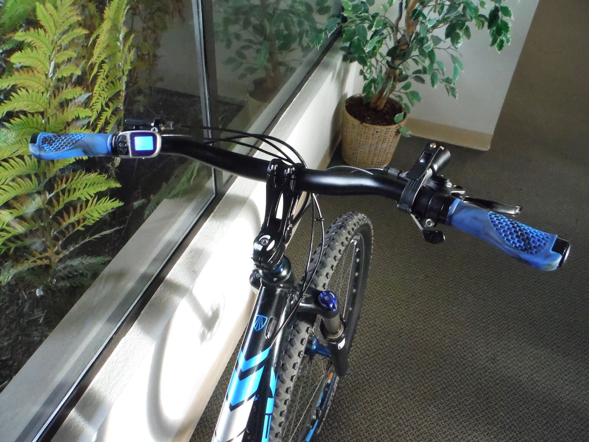

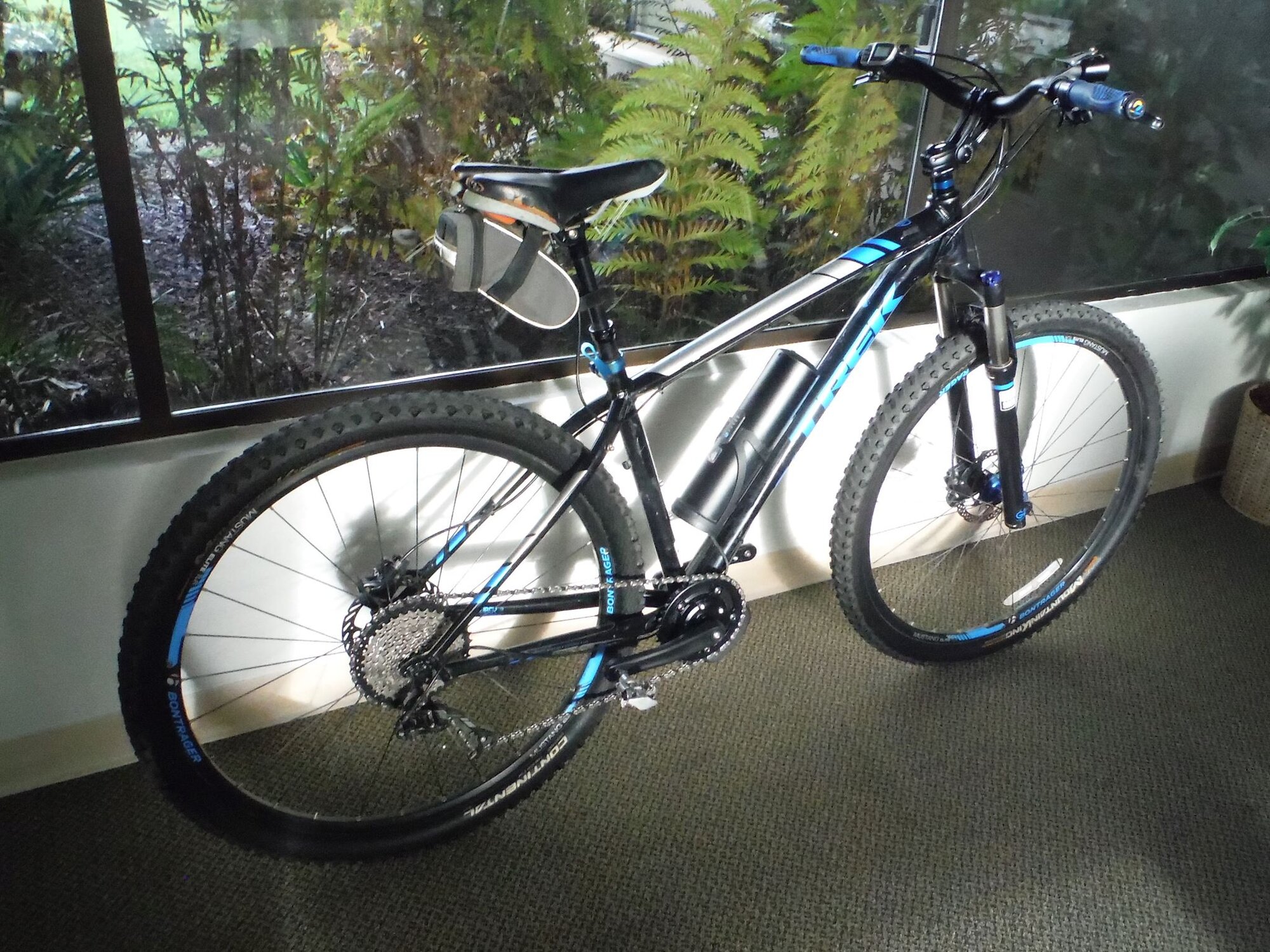

Here is one that is going out in 45 minutes. It is a mid-drive with a torque sensor and active sensor of cadence, in other words it has a power meter. It is a 90 Nm 500W cargo motor with a premium battery. The owner rides Mt. Tam where mountain biking was invented. It is geared for climbing. I installed a comfort bar and matching grips with a stem riser.
I don't doubt that many torque sensor bikes also need cadence sensors. There are probably plenty of power delivery situations where the algorithms want to know if the pedals are spinning too, And that would apply if the torque sensor is in the rear axle. The electric brain also wants to know if the gears, hence the wheel, is moving .
