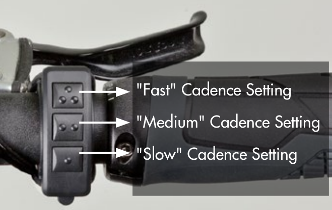

Incidently, someone I know got stuck riding uphill with a Dutch cargo trike that had a Bafang mid-motor with a torque sensor and an Enviolo gear hub with an automatic shifter: In the "fast cadence" mode, she spun like crazy with the bike going nowhere (because the Bafang thought she didn't need help?), while with the "low cadence" mode, the motor did provide significant power… but the cranks would get stuck in place — we'll never know if it were because the shifter chose a gear ratio too big for hills and/or the bike came with a chainring+sprocket meant for flat terrain.
