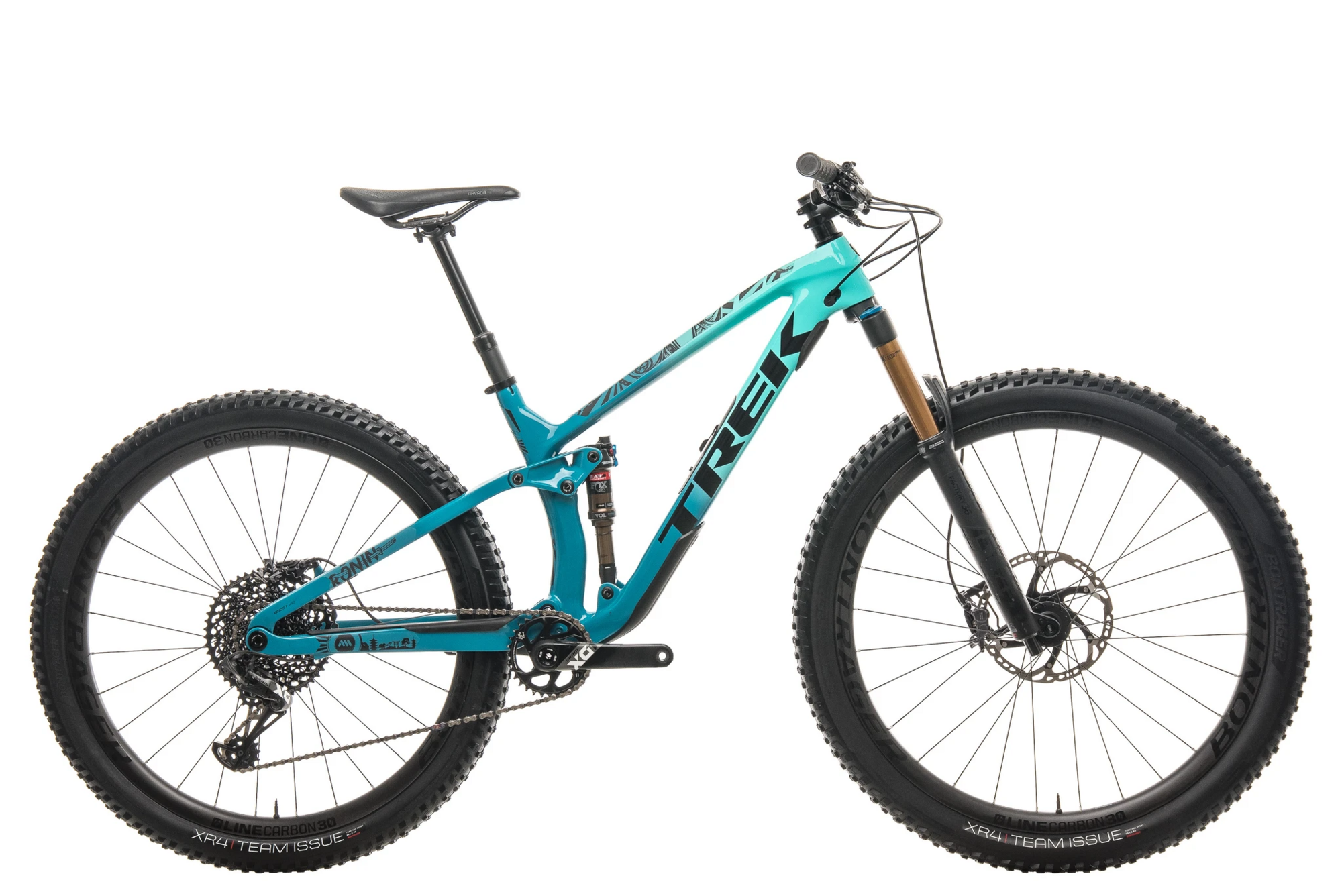

Essentially lower angles on the neck and seat tube, which puts the rider further back on the bike.
Another way of saying it is how far out in front of you it puts the front wheel.
Think where the wheel would be at 90 degrees.
The angle will also affect the ride and handling. Think of this bike with a 90degree headtube. It would be VERY easy to go over the bars(OTB)
since the rider would be positioned more forward over the front wheel.
And with the wheel further out it steers different.
So bikes have different geometry based on the type of terrain they are intended to be ridden in. And of course some bikes try to strike a balance for all types of riding.

What confused me for a while was just where is that angle we are measuring? It is from the ground. Not the top tube. You can see this if you search bike geometry on the web and look at the pictures and their labels.

Compare and contrast, my slack daughters Scott on the left to my Sharp daughters old fashioned giant on the right.
Now removing my smart arse hat for a moment, the modern raked out Scott with low bottom bracket and short chain stays is amazing to ride - stable over rocks yet accurate steering, it gets power to the ground heaps better than that old giant and is fantastic fun in the air. Oh, and the seat to bar distance on those bikes is almost identical, both fit a 5'11" rider ( me) , and both are fun in their own way. The old giant is incredibly nimble and great fun to zip between trees on....but just a little scary if you try and keep up with the slack daughter downhill......

Is it normal that all our families bikes measure 1 degree slacker with rider aboard ( up on the pegs , the difference is up to 2 degrees seated )? Irrespective of a stock 69 or 64 degree manufacturer head angle we all went an extra degree slacker when riding. And I thought we had even sag front to rear!
