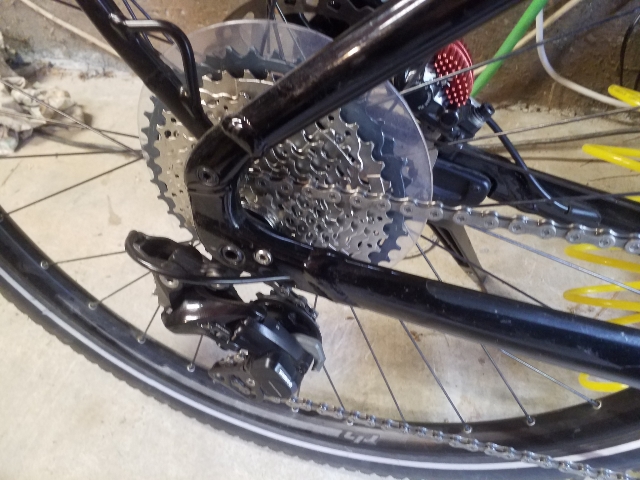

All bikes should have regular maintence on their drivetrains. I clean and lube my chain every 300 miles or so, more if I ride gravel. I inspect all the parts at each cleaning and lube the derailleur. I just replaced my chain and removed and cleaned the cassette after 1,000 miles. I'll keep repeating this every 1,000 miles or so to minimize wear on the more expensive cassette and chain ring.
New chain and a deep cleaned cassette.

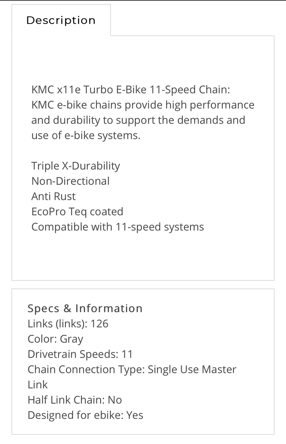

@Sierratim this is the chain LBS put in my Vado 5. What do you use?
Ebike specific chains are popular, though I haven't found any data comparing life to 'conventional' brand name chains when used in a mid-drive motor application. My replacement chains are Shimano CN-HD701-11, a step up from the chain provided by Specialized.
BTW - I did find at least one post that reported similar life between ebike specific chains and conventional name brands. Just one data point but better than no data.
