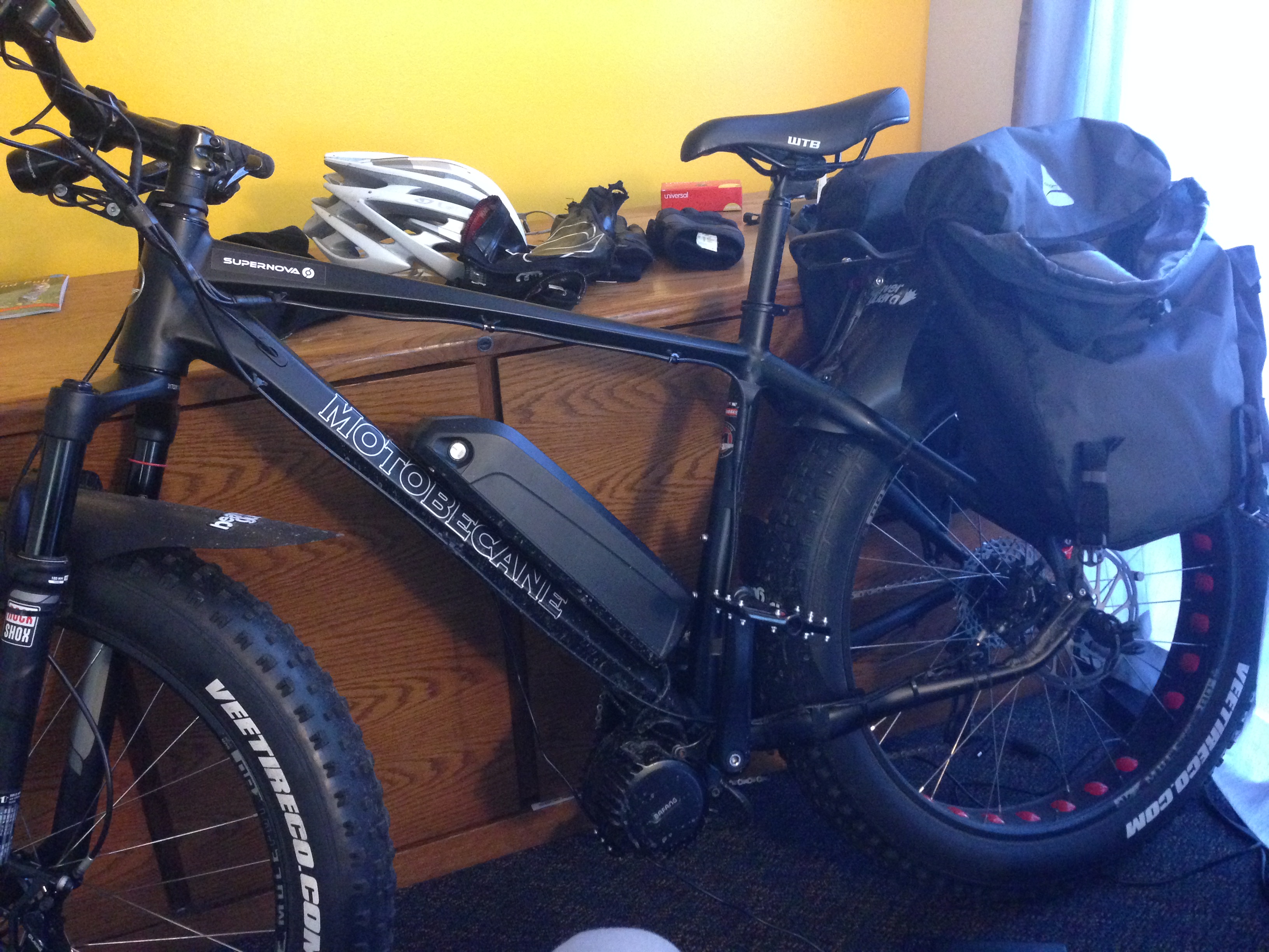

@Alex Smith you will not be disappointed with the BBSHD. Great point on the lights. I spent more money and did the Supernova e bike lights and wired them directly into the battery. Best decision ever! I love not thinking about them dying out on me. I press one button and the front and rear lights are illuminated. If you don't want to get sweaty the BBSHD will most definitely help you. Attached is my commute from this morning. I rode in PAS 5 and barely had any sweat at all, granted it was 32 degrees this morning. I have over 200 miles on this bike so far and everything has worked great besides the original dolphin pack battery which Luna replaced with a shark for free. I love the look of the shark anyways.
