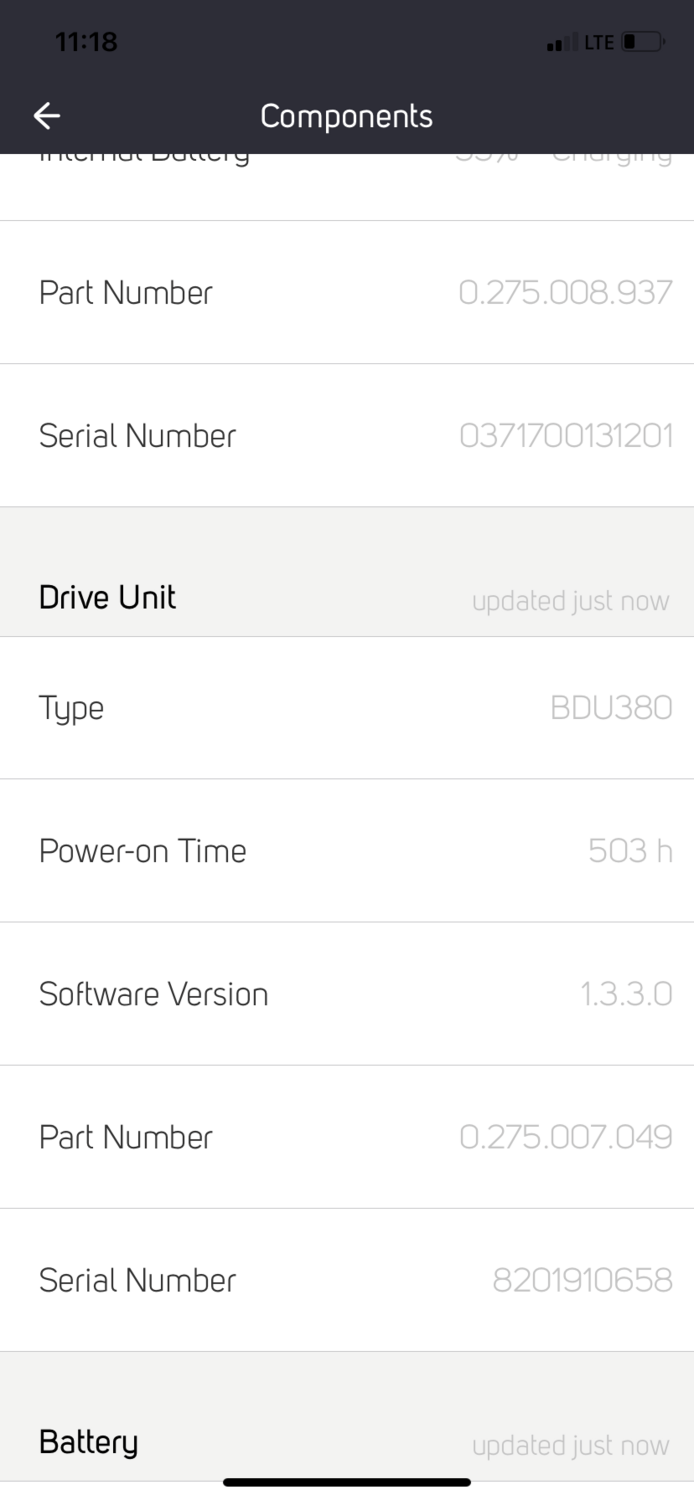

Moving beyond updates, my other question is why the system doesn't report anything about the DU, even though it does for the battery and for the hub. I don't think your nyon experience is very relevant to the smartphone hub, especially since cobi.bike wasn't even developed by Bosch.
The Bosch eBike Connect app will not alert a rider of updates available for the battery and drive unit. It will give you notices when entering the app if updates are available for your Kiox or Nyon.
That is odd your drive unit is not appearing. Have your tried removing the bike and reconnecting the the hub? Here is a screenshot of my Cobi app this morning with components.
Thanks for your reply, Stephen. Just did an experiment - took an older phone with cobi.bike 1.18.1 - not updated. It read the motor information fine. I'm going to go for my first ride of the year, and will update this older phone when I return and see if it's phone related, app version related or just a random glitch.

I now vote for random glitch. My older android phone worked fine for today's (short) ride. Updated cobi.bike upon return, and the updated software still showed the DU information with the old phone. Since that's the one I use for rides (my newest one stays stowed), I don't see a problem going forward.
