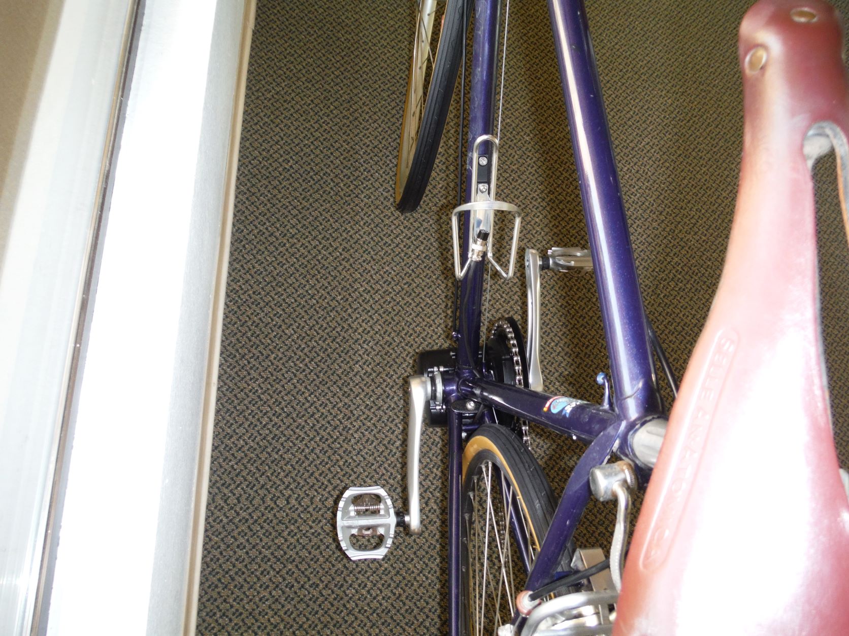

That does make sense for many of them. Particularly with in-frame batteries. My batteries typically are as easy to remove as a water bottle. I then cover and seal the connector with a very small ziplock bag. Here is a bike with the battery removed so you can see the connector. It is easier for me to flip a bike that to bring a portable stand outside.

There is a thing called "a kickstand", Uma :) Even with kickstand-less e-bikes it is not that difficult to support the e-bike against something for washing...
Mid-drive motors have some holes in the motor cover (to remove rainwater, for instance, or for better cooling). While the motors are waterproof, you don't want washing water to accumulate inside and possibly ingress the frame tubes from inside.
I will use a kickstand when I flip one back to get the top side. Or I will put a bike against a wall. I seal my motors and just have a small breathing port deeply recessed and covered by a plate. I use very low pressure. Spray bottle pressure. Precisely directed. It is very important to not use a pressure washer. I also cover leather parts such as grips and saddles.
