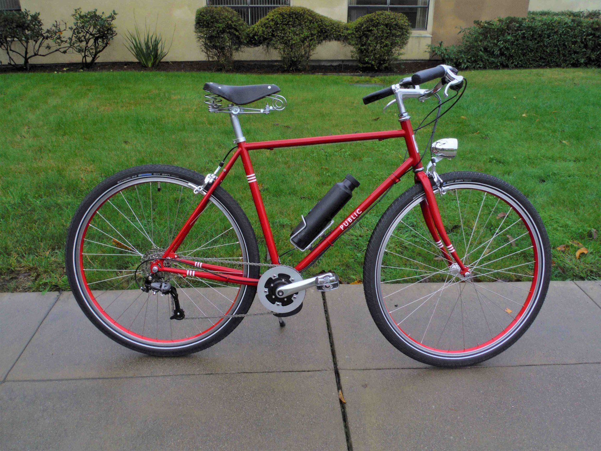

Looks like you have a dummy chainring functioning as a chainguard on that bike?

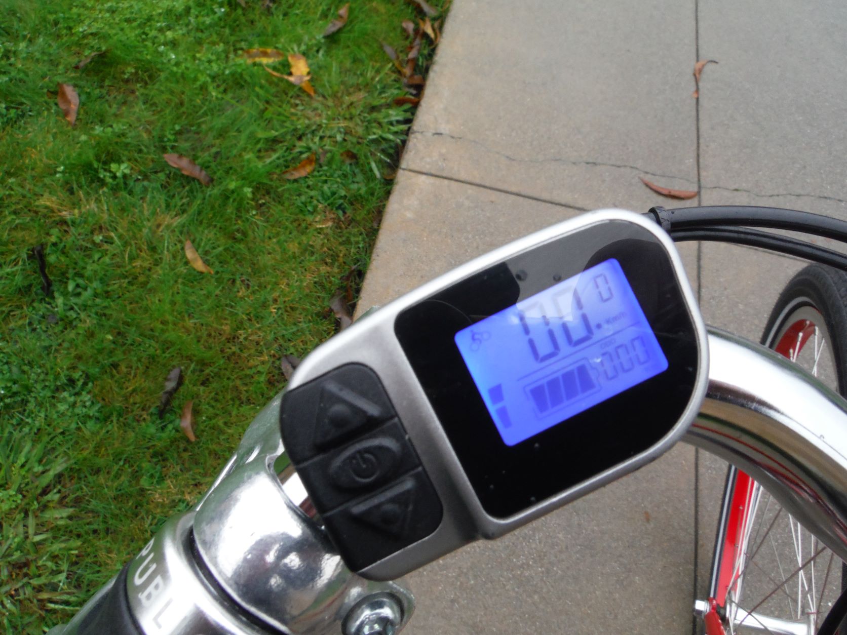

That is right and thanks for the tip. I took the original 110-BCD five-bolt chainring and used it to cover the all black motor. Lens is super helpful when doing things like trying to source a controller. You just photo the label with its barcode. Controllers for bikes over six-years-old are very hard to find. You might find a used one, but who knows on that crap shoot. The planned obsolescence in the industry sucks.

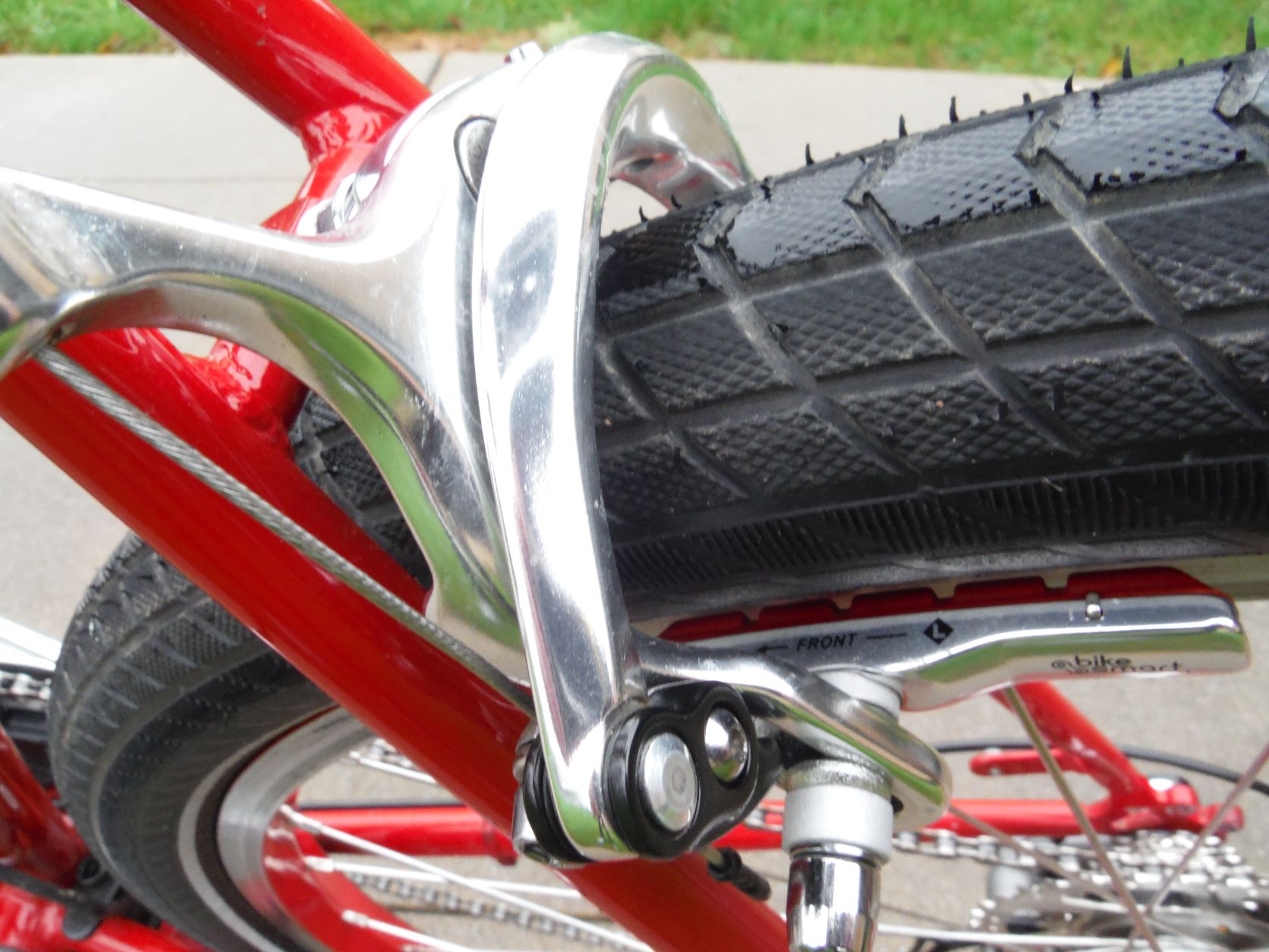

This is another Mike's Bikes Mega Sale $450 V7 from 2020. It had small brake pads and a black freewheel cluster, with cheap grips and a brown vinyl saddle, and skinny white tries. I installed the TSDZ2 motor and the battery. The sedate original suddenly looked kind of bad-azz. A three chord rock song with red, black, silver. For the directional Super MotoX tires I had to remove the fenders and deflate the tires to get them in. It just fit the stays. Mike's owns Public. Mega Sale is in mid-August and again in March. You can pick-up an $899 IGH Nexus, R-18 disc bike for $549. I made the long MTB pads match the bike. Those e-50 tires fly over broken pavement. I have never seen this bike since. I reused the original chainguard on the ring. The bike quietly does twice the speed of a Sefaninan.

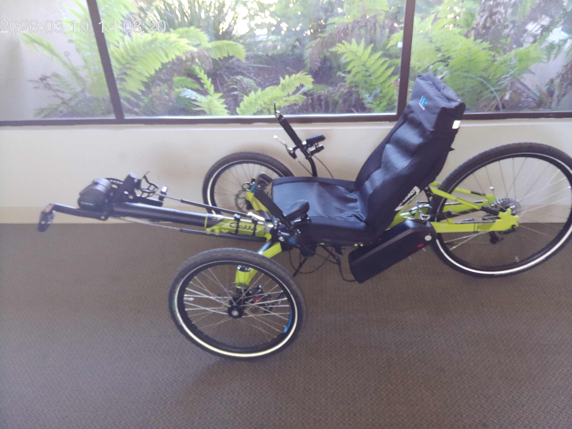

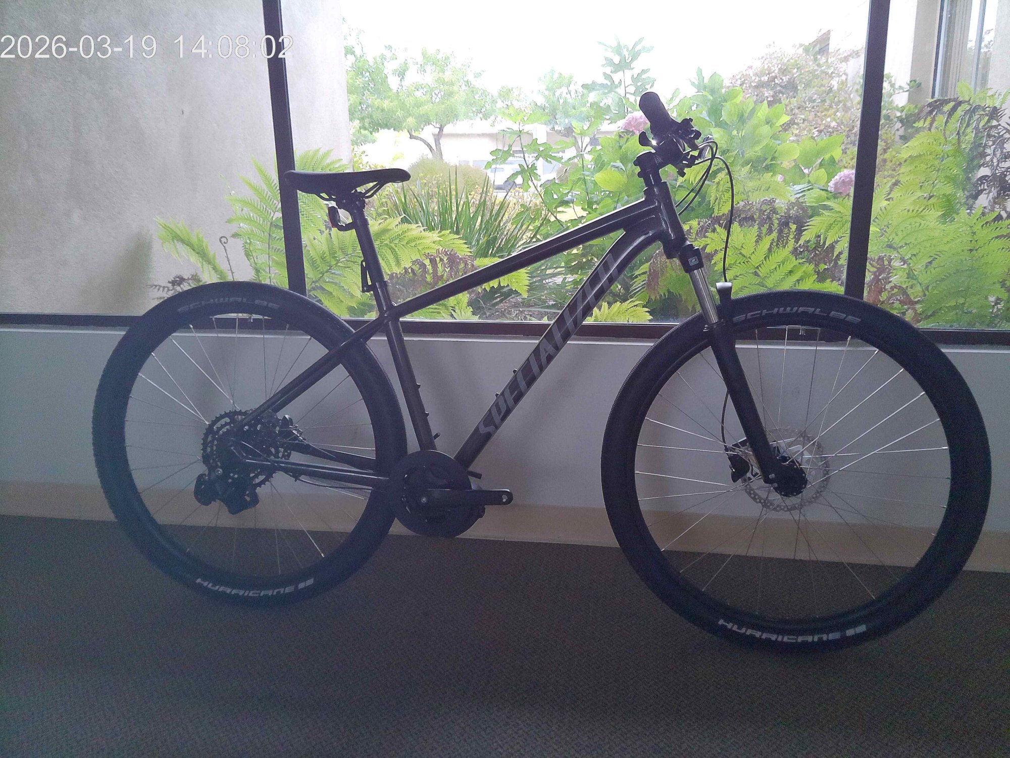

I finished the recumbent trike yesterday. One problem was extending the speed sensor. Because of the added length I used heavy gauge wire between the battery and the motor. I am working on the Rock Hopper now.

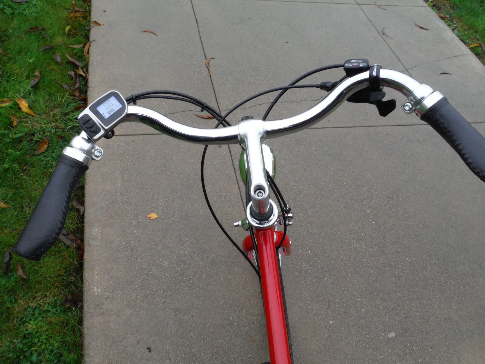

I installed the throttle but used marine grade heat shrink over the connector with a Schrader dust cap imbedded. Then I painted it with three odd colors and adhered a PedalUma sticker to it. It cannot be tampered with and be made to look like nothing happened. It will be up to dad to cut it off when he thinks his son is ready. The thing can be ghost pedaled anyway.

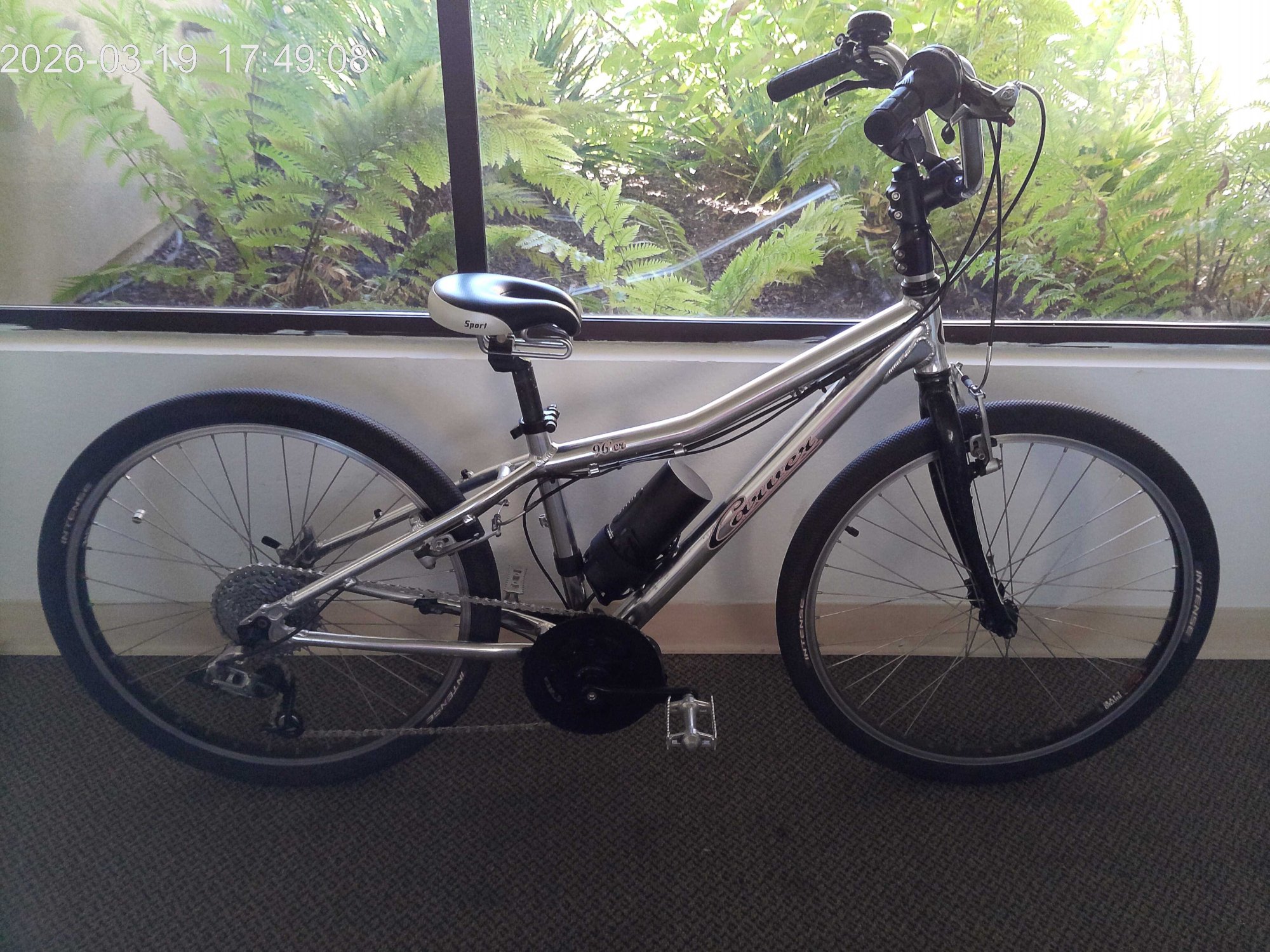

I finished this one yesterday. It is going to a little person. She can barely stand over it. It is so she can keep up with her cyclist husband. Those are 24" tires a second grader might have.
I spy a Chinese ISM clone saddle.

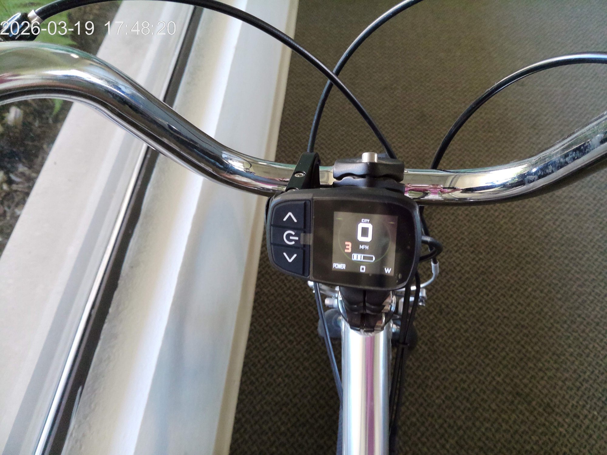

Yes, it could be. It is a lot like the ISM Touring saddle. It was there when the bike came in. I had to go with a 7Ah 36V battery to make it fit. I used a section of an accessory extender to mount the display. There was no other place to put it.
Edit: The saddle has a blue logo on the back that says in white lowercase cursive ism and on the side is says sport. I just noticed when I put it on the charger.
Terra the little person picked up her bike today. She arrived with her husband at 11 this morning. He did not tell her so it was a surprise. They left at 1:30. We went over the bike then went on a big test ride in the hills. She kept crying. She was able to out-climb her cyclist husband on his Santa Cruz 12-speed. Then we got coffee by the river where she told people about her bike and showed them. More tears. We came back to my workshop and I answered more questions and gave further information. She hugged me while I was seated. More crying for joy. It has changed her life. She is so happy.
