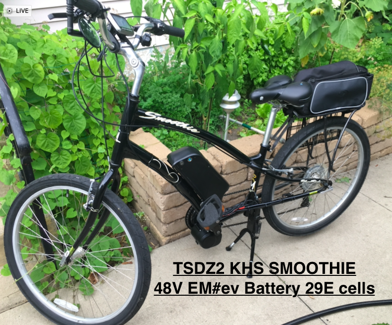

Those flat foot frames are incredibly comfortable. My TSDZ2. Gifted to an old buddy living rough.
I have a Trek Pure and all three KHS flatfoot frames. Vintage Townies are incredible frames. The 7D like yours still have better components. I upgraded many KHS components.
