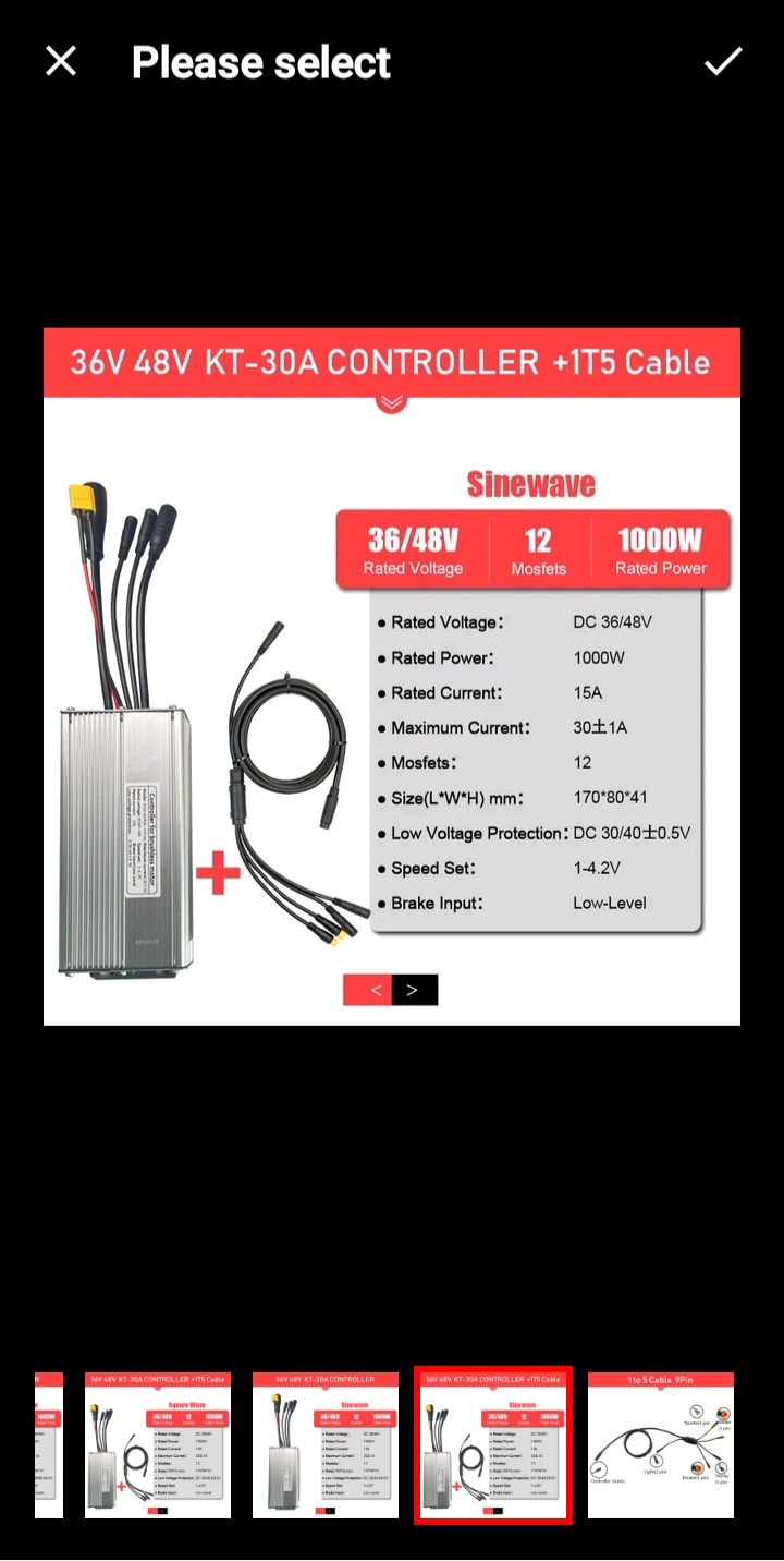

You could get a 30 amp Sinewave KT Controller if you have the physical space to install it.
This one has 12 mosfets and waterproof connections.
There are SM plug versions too if you need SM connectors.

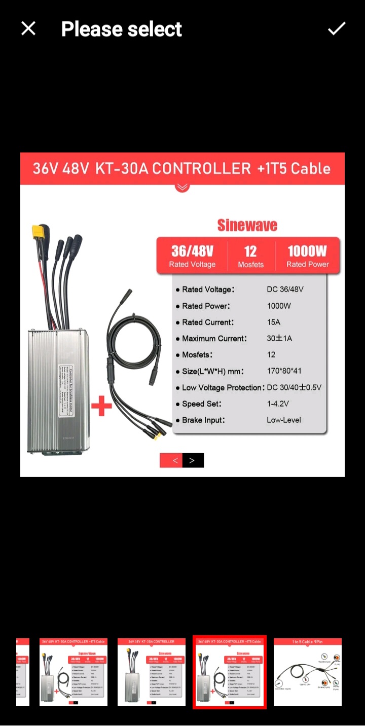

I looked into switching to a 30A, but unfortunately, I don't have the space. So, I have no choice but to go back to my original controller, is that correct?
As far as I remember, once a KT Controller goes over 25 amps, the Controller gets bigger.
There may be some other type of controller available with 12 MOSFETs in a smaller box.
Your ebike probably isn't the only ebike with a Controller like yours.
That's right! Controllers over 25A are about 170 cm long, and those over 40A are about 230 cm long.
I tried to search but couldn't find anything. If you come across any information, please don't hesitate to send it to me.
