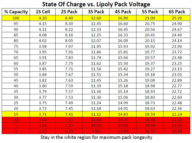

The voltage/percentage capacities you state above vary significantly from from the graph I re-posted yesterday:
I'd like your input to clear up the discrepancies.
For instance the graph I posted shows 56.3 volts as an 85% charge on a 52 volt 14s pack (-vs-80% on the list above) . Which is correct?
The graph also indicates a 20% state of capacity is 45.4 volts -this also varies significantly from your listing of 48.7 volts.

Who originated the chart? No single resource is going to be perfect, and the charts here show why: https://lygte-info.dk/review/batteries2012/Common18650CurvesHigh UK.html

The graph @bikerjohn posted doesn't reference mah at all, and isn't relevant to capacity. It would be equally accurate (or not) whether your battery has 4 or 40 mah.
Is the chart accurate? Experience of a lot of us suggests that yes it is, within a couple tenths anyway.

Look at the 1s cell voltage versus the capacity %. Multiply your cell count to get your voltage level.
Based on the chart above. A 13s battery, or 48 volt as there labeled, would be 20% 48.9 volts and 80% 52.26 volts. Capacity doesn't matter. Only cell voltage. Now these numbers will change a little as a battery is used and aged but not much.

Your graph is the wrong one. Not your fault.
The graph i just posted comes from a lipo manufacturer and not an ebike shop.

View attachment 28517Look at the 1s cell voltage versus the capacity %. Multiply your cell count to get your voltage level.
There is a very significant discrepancy between the charts at 20% !
Based on your formula for using the chart above, a 14s battery, like the CCX 52V battery, has a 20% voltage of 52.22 volts. How are you able to verify the charts accuracy? Where can I find a link with a write-up on the calculations related to this chart?
It took me a while to figure out what they did wrong What's wrong with that chart is they are using 3 volts as 100 % discharge. Lipos are discharged long before that. So there basing there math on 3 volts to 4.2 That chart might be outdated too.
I own a lipo battery business and work with the engineers that make the lipos I sell. They agree with the chart I posted and that works for me. Sorry i don't have any write ups to point to.
LiPo is different chemistry. The chart Bikerjohn posted is correct, within the usual variance.

Lipo is not a different chemistry. What do you think is in your bike pack?
You can believe what you want, but that chart is very wrong.

The chart I posted is an updated chart. I am the North American distributor of the battery I sell. https://www.dinogylipos.com/
I sell to top racers in the country and have to know what i'm talking about. I get my information from a lipo factory and the engineers that work there. Not an ebike shop.
The chart from Juice is wrong. Sorry to be confusing. My goal when I come on here is to help educate you guys.

Your numbers are off a little. Take the chart I posted and use the voltage numbers in the 1 cell column. Multiply by 13 to get your percentage. 20% charged would be 3.73x13 =- 48.49 Do not go below this number if you want your batteries to last longer.
80% full would be 4.02 X 13 =52.26 You can go as high as 4.10 and still get better cycles compared to 4.20
I have been teaching my customers how to take care of their batteries for 7 years now. I recently got into ebikes and can't stand by when I see bad information being posted. The juice chart posted is close on the top end but goes horribly wrong down on the bottom.
