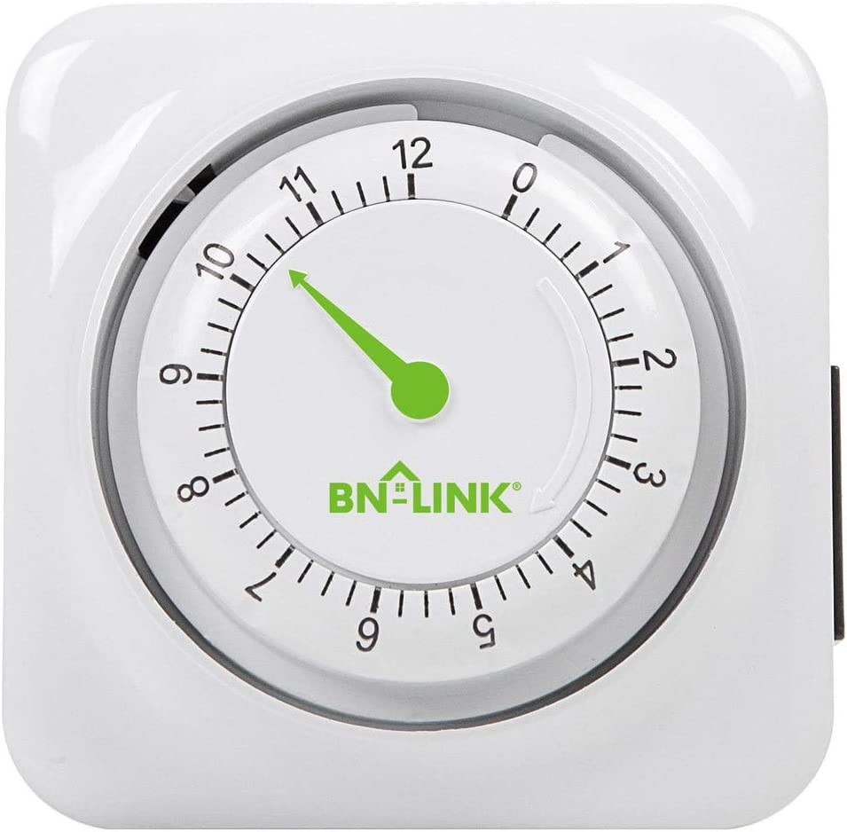

I would, however, add a dumb timer to a more robust power strip. In one case I have a 1500w UPS with a timer hooked up to one of the plugs in the back. One of these. A whole $9.99 and it is a fail-safe that you never need to remember to walk over and switch off. Just learn how many volts per hour your charger adds to your battery and set it to cut off before then. This is a cheap way to buy yourself the benefit of 80% charging.
This thing is mechanical so its pretty much idiot proof. 12 hr limit.
