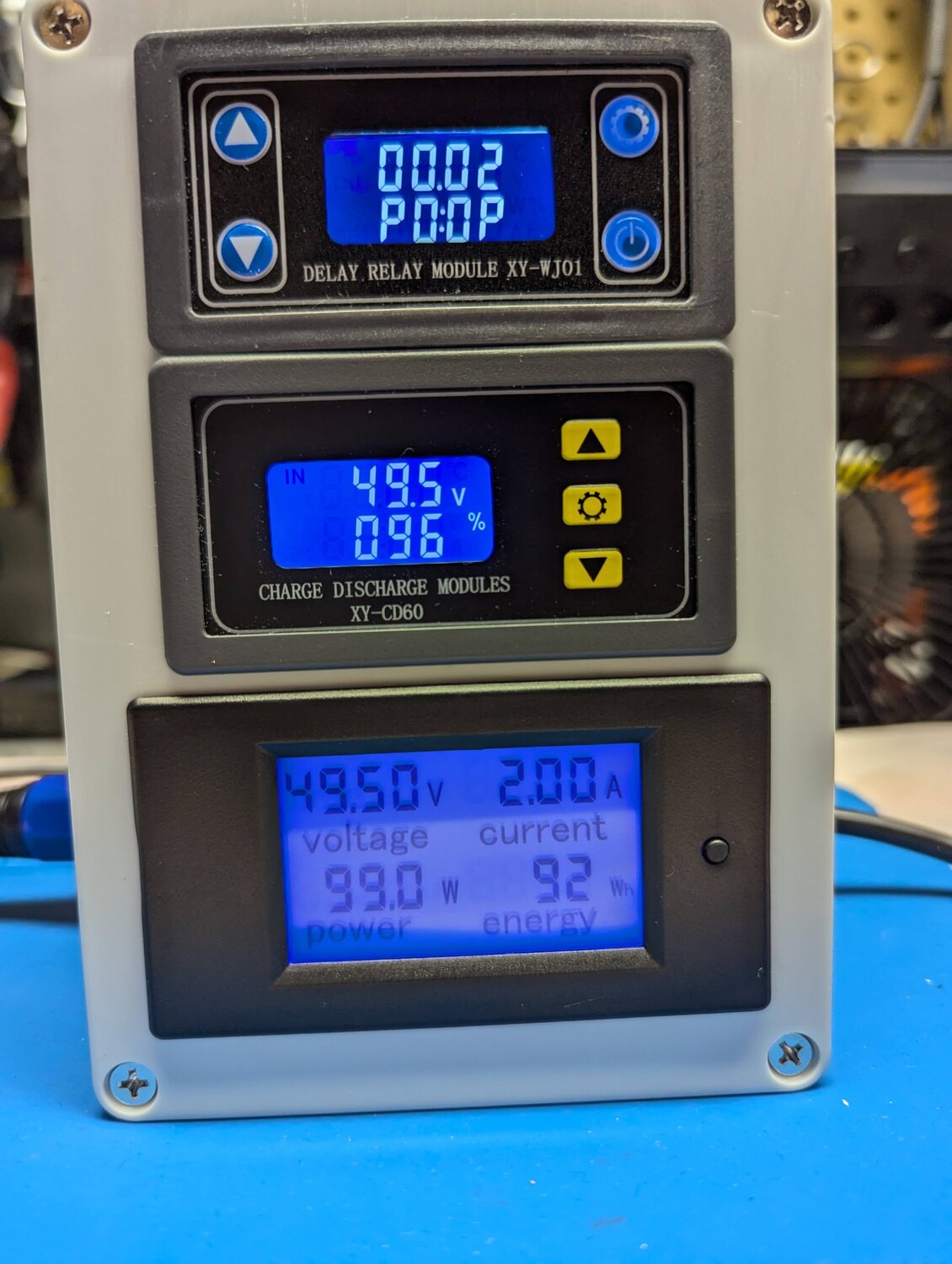

I've put together several of these....
Charge to any SOC you desire from any starting point and also has a built in timer as a secondary shutdown.
Since it disconnects the load afterwards, there's no vampire discharge if left connected. Add a home automation outlet and you can set it to start anytime or on demand with the app.
