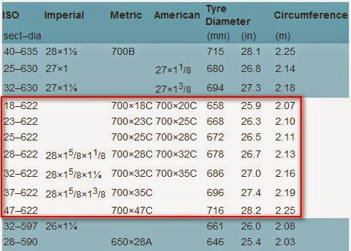

29ers actually have 700c rims but with higher tires. Both are Etrto 622. You may be able to install slimmer tires to bring down the bike to 26.5 without changing the rims. Ask your local bike shop if you are not sure.
