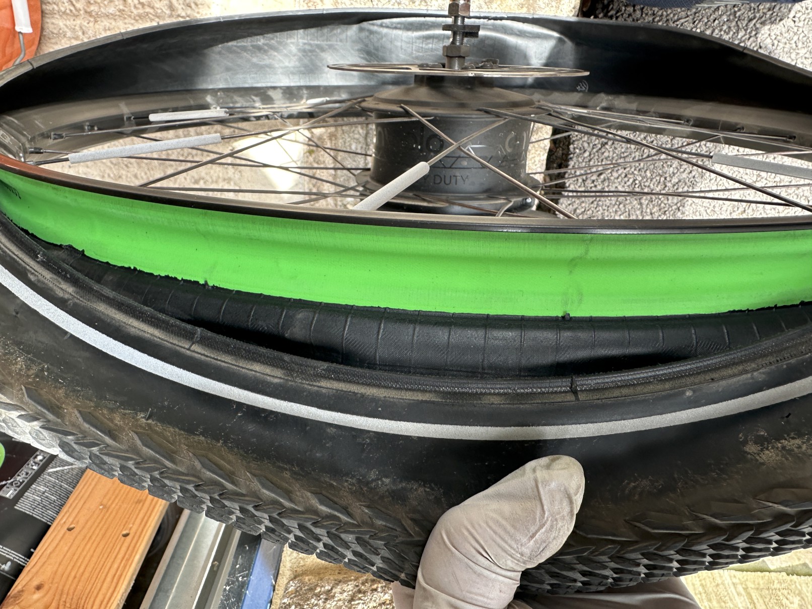

I do have a question, though .. seems my tyres (Pathfinder Sport) are somehow connected to the rim on one side? Is this normal .. how do you get them off if I wanted to change the tyre?!
With a tubeless wire bead tire, you have to break the bead from the rim. If you don't have a bead tool, push with both thumbs as hard as you can to try and open up a gap, then use a tire lever to pop the rest of it off. I've also used a 1" putty knife, carefully.
Hmm, interesting, thanks. I did have a fairly hard poke at them, but didn't get it to break away. I'll try a bit harder when the time comes!!
I didn't realise these could be configured tubeless. I assume to do that I'd just need to get some liquid and a new valve .. perhaps something to consider next time I get a flat as I guess I could have kept on riding if I had.
