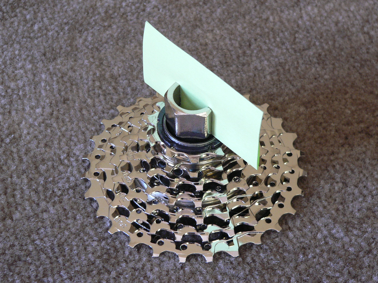

The stock freewheel (on my 2018 RadMini) is a Shimano MF-TZ500-7 with tooth count of 14-16-18-20-22-24-28. If you change to the DNP 11/28 freewheel (link below), which is a direct replacement, it has tooth count of 11-13-15-18-21-24-28. With the DNP, you are reducing your pedal speed in 3rd through 7th gears, but the two lowest gears (1st and 2nd) remain unchanged. Replacing the freewheel may require a special deep thin wall freewheel tool.
