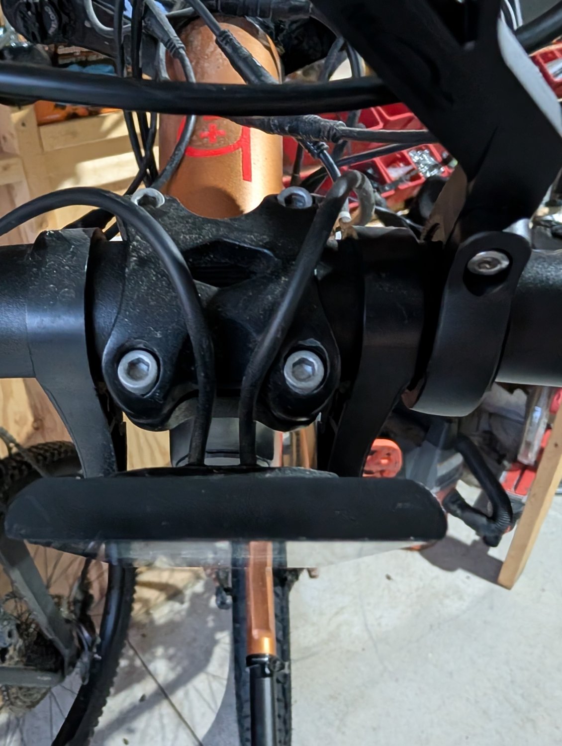

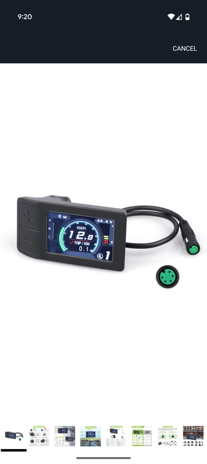

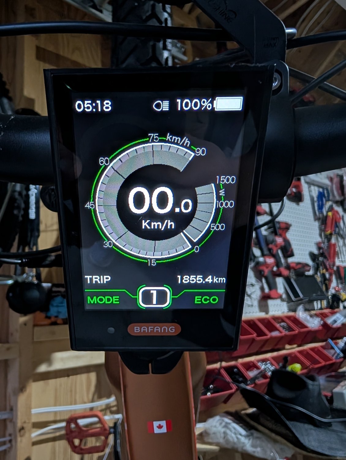

So I know people will disagree with me but I am NOT a fan of these huge screens to only tell you the time, speed and battery info. It takes up the entire center of your bike where I would rather mount my phone. I would like to know if it is possibly to change the screen on these bikes?
I have a Biktrix Juggernaut FS 2 that has the 1000w mid drive and I also have the Voltbike that is the 500w mid drive and both have the same Pedal assist changer and screen. It has the round 5 pin Juliet connector but I cannot find out if the smaller ones will work
I was looking at the BBS01B and 2B but was looking for the under mount one C241.CAN

It looks like Biktrix has an entire document that shows you all the different screens that work with their different bikes
This is awesome!! Looks like it supports a BUNCH of screens including the 500C
From my experience all Bafang UART displays work with UART mid drives... But this is not 100% guaranteed.
If you have CANbus I'd be more careful as firmware is much more detailed and specific.
