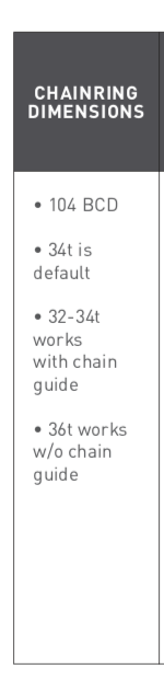

Thank you for your replies. So it seems that the only obstacle in going bigger is the potential for clearance issues.
I found this today:
  • Workbook_Turbo_Levo_Gen_3_2022.pdf
