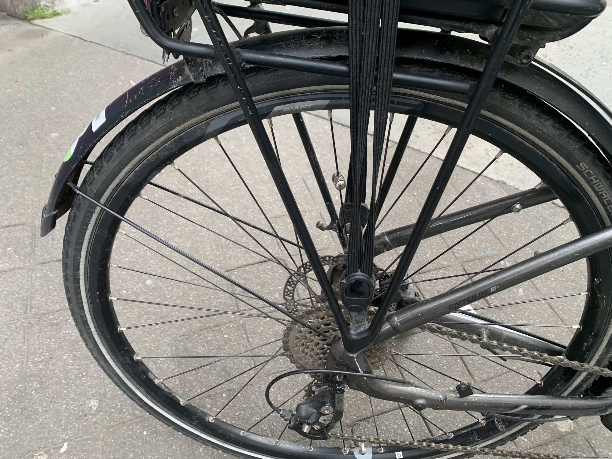

The derailleur itself may have also lost tension which will be most obvious in the smallest cog. The Altus derailleurs are dirt cheap so maybe consider replacing this and having it properly aligned at the time of fitting. That chain also looks a little loose - largest cog would see the derailleur in the circa 5 o’clock position. I would try removing 2 links.
I know the chain is a little loose. But I've replaced it three times. Also as I mentioned the cassette. Each time it works for about a month. Each time the Giant mechanics mention that I'm wearing the smallest cog down by forcing. On the other hand I like going fast. Maybe it is time to change bikes?
I agree with Juggernaut, your derailleur should be at 5 o'clock while on the largest cog. That might help if your chain were tighter.

Indeed. I replace the chain quite often and have since that old photo. But even the "new" chain is getting loose and yes the 8th gear's teeth are getting worn. I hate to ride in 7 when I can in 8 it is just a little slower. I'm going to try to degrease the chain soon to see if it is going to help. I have my usual "gig" in July so I'm going to wait a month to get Giant to revise all = new cassette, new chain, get the derailer correct (I'll try your suggestions this week for the alinement in the interim), and maybe the plateau. Also brake pads and maybe a purge?

Hanger has to be pretty bent before it causes consistent issues, but its an easy thing for a shop to check and fix. I do suspect the chain is a bit long, based on the one picture that was posted (which had the chain in the large cog in back and the derailleur wasn't highly tensioned as I'd expect). But it does really just sound like they are running high assist and primarily riding in the highest gear, which is going to cause a ton of wear on that cog. Small cogs (on normal bikes) aren't usually used in a high-power way, they are to maintain at higher speeds. The chain is only engaging a few teeth on an 11t cog so big mid-drive power through that is going to wear it fast.
