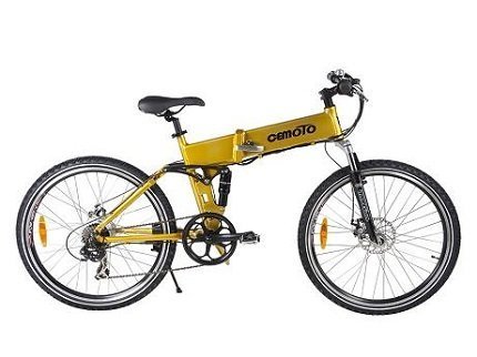

Cemoto Electric Folding Mountain Bike
Hello all,
I finally got around to installing a rear rack on my Cemoto. It's the Delta Cycle Mega rack I bought online for $19 free shipping. The left side mounting bracket I had to use a longer bolt to clear the rear brake assembly but everything else was straight forward with the installation. Enjoy the photos.

Thanks, I was glad to be able to install these traditional rear rack. I do not like the kind that mounts to the seat post with no side strut brackets. Now I can carry more cargo, I might take off the front basket.
