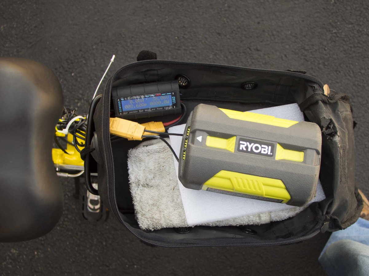

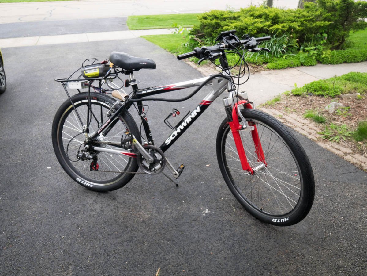

Which begs to be asked, how do you adapt a lawnmower battery to your bike.
LOL.....good question. Spade connectors and small jumpers. If it was something I actually considered doing regularly, I would come up with something more
permanent. Before my regular battery arrived I did this to make sure everything else was working. I was surprised at how far it went on the lawnmower battery.

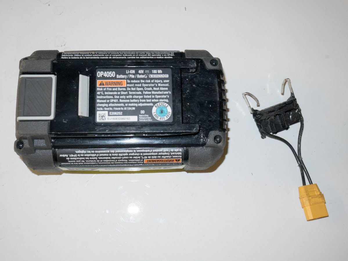

Ryobi 40V battery . It's actually a 36V pack in the ebike world, with 20 cells inside, but it's small, so there's very little power left when it actually hits 36V. I have a 1.5AH unit from my weedwhacker. I get about 8 miles on it. My wife could get 10-12 miles. Not cost effective unless you already have the lawn tools, but if you do, it's a little bonus. It's fun to throw on the bikes once in a while (along with a real battery as a spare).
View attachment 35895View attachment 35896View attachment 35897
There you go. Basically what I suggested earlier. You made a little more permanent connector than I did.
