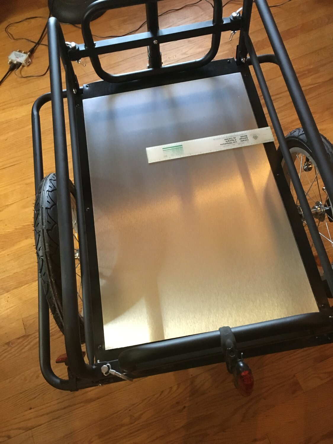

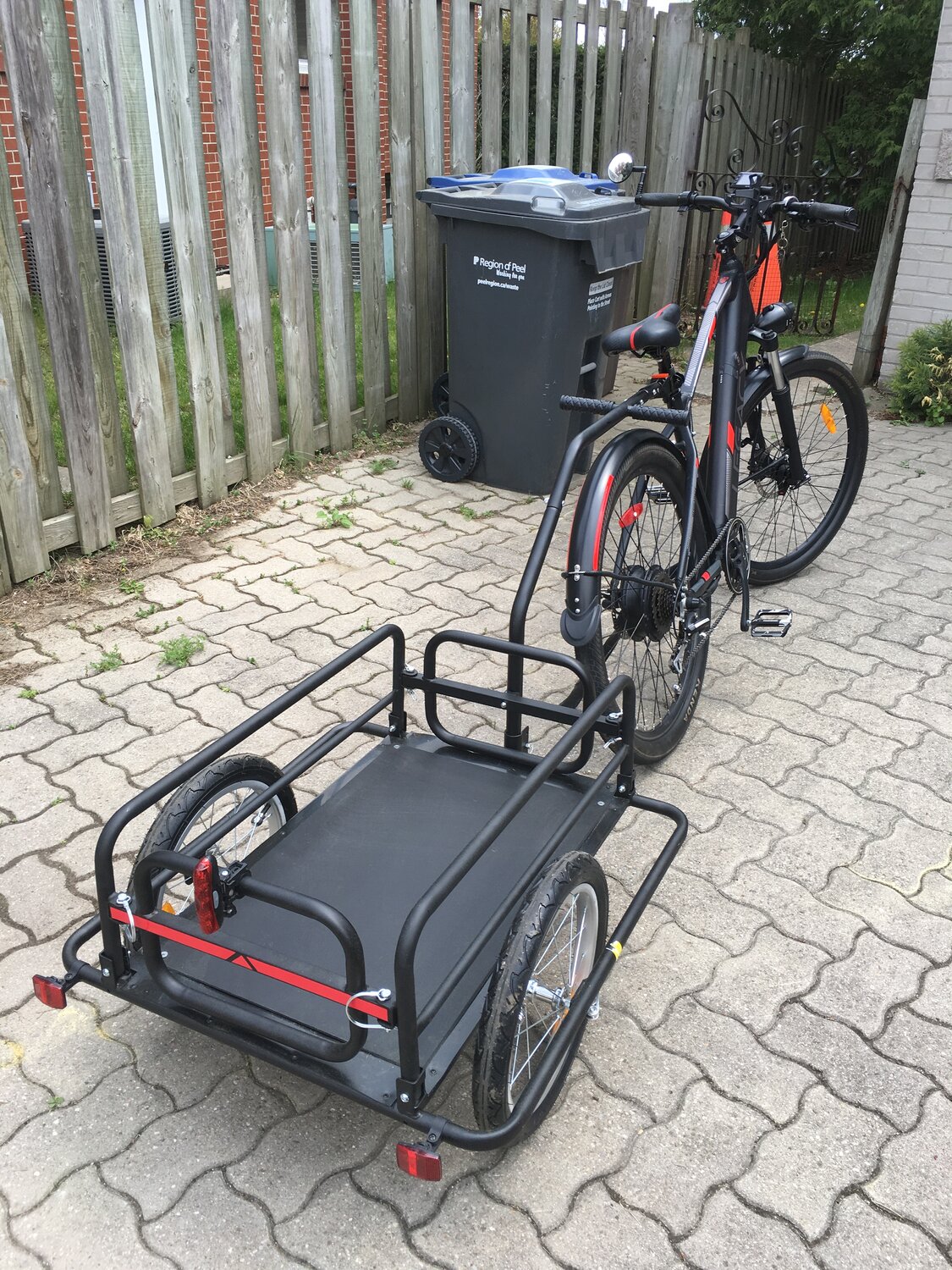

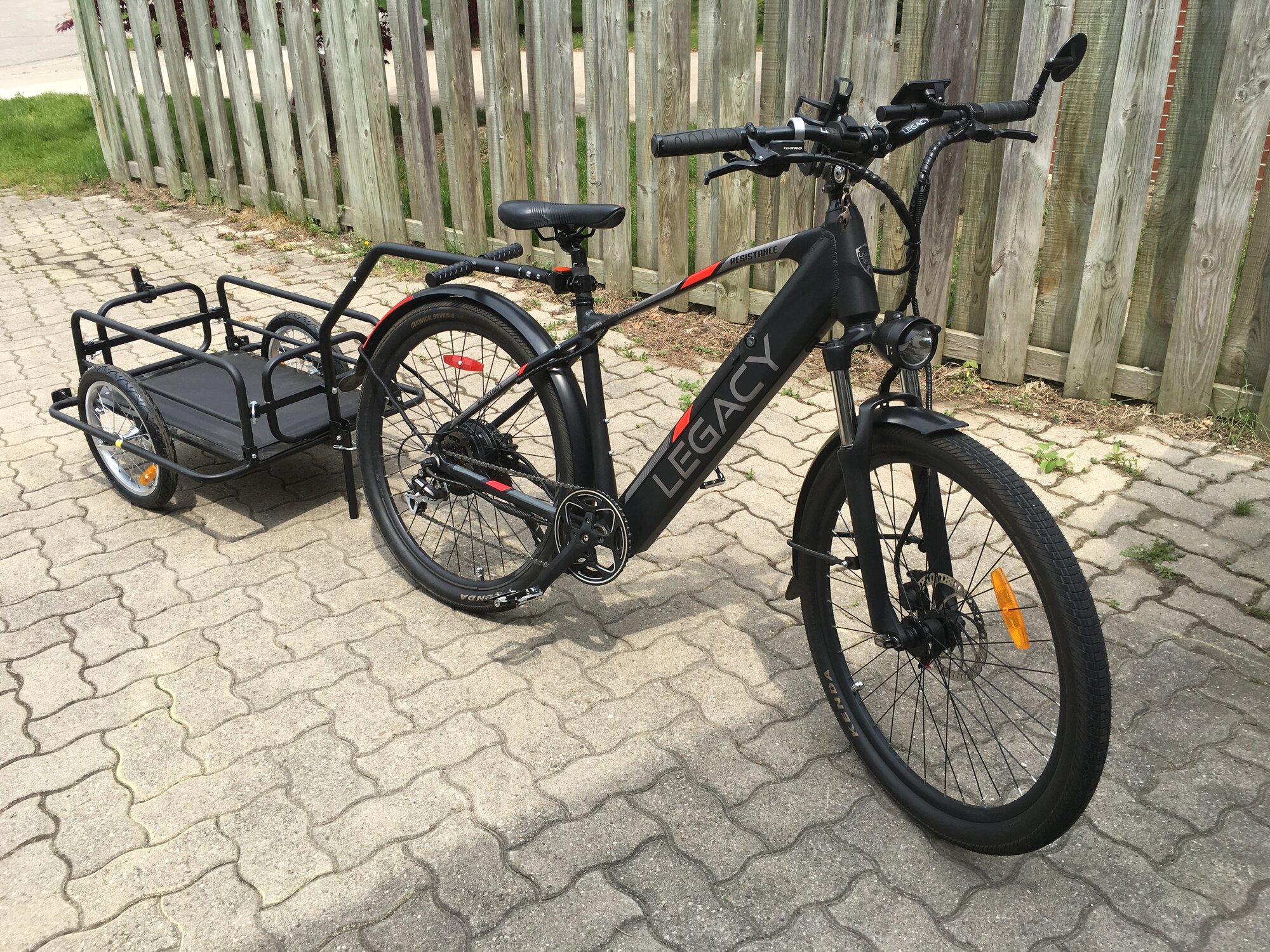

I bought it. And I'm happy with the trailer.
To use it I had to remove my rack (4 hex bolts). Thudbuster seat post and dual spring saddle. I use the original seat post and saddle.
The reviews online said the trailer bed was flimsy and it was. I reinforced the bed with a piece of Aluma-plast.
Aluma-plast is a material of ridged plastic sandwiched top and bottom with aluminum. It is very light and sturdy.
I sprayed the top of the new trailer bed insert with Dupli-Color Aerosol Bed Armor a rubberized spray that protects truck beds.
I don't care about 88 lbs. it carries way more beer, groceries and garden supplies than my panniers do.
Nicely done. Looks good with your bike also! Yours is different than the one I got from the link above. Yours is wider and foldable I think. Had the good fortune of finding a 20 gallon tote with lid that fit mine perfectly so I swapped out the included plastic tub with canvas cover for the craftsman tote(Red and Black). Made a few other "2.0 upgrades". Check out the video if interested in seeing what I did with it.

where did you get the aluma-plast?
