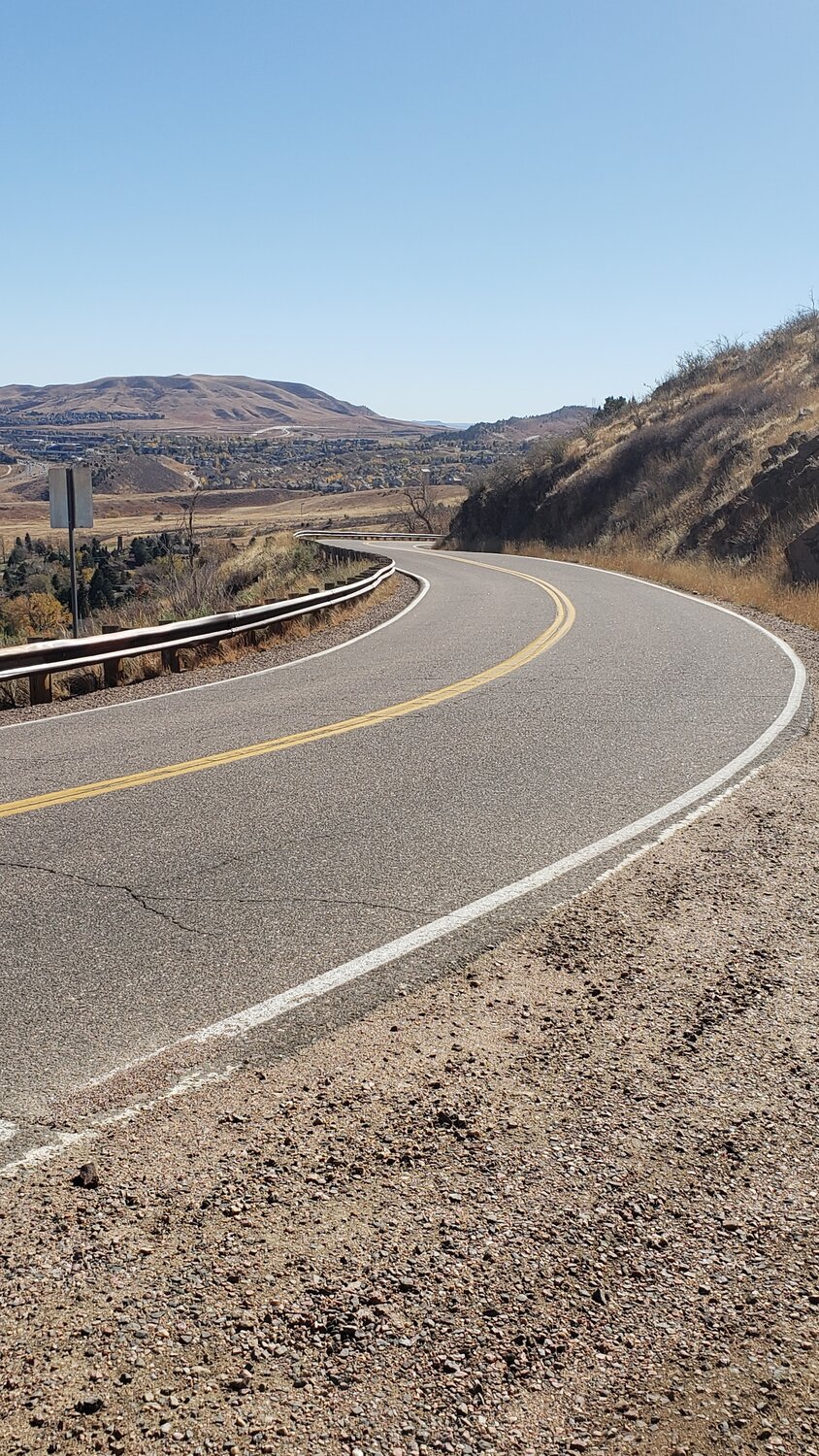

I hit 35 miles an hour going down this hill
