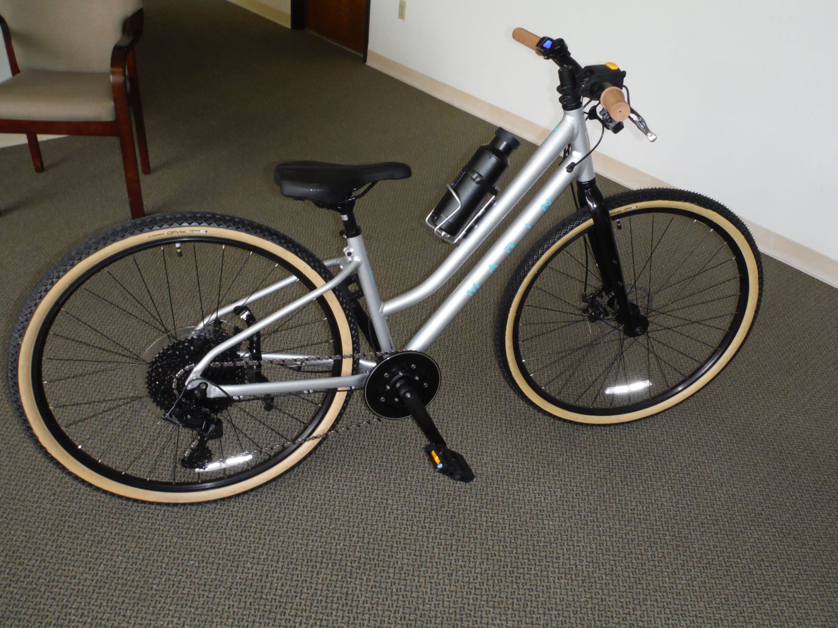

Welcome! Don't get stuck on number 5. Tires are easy enough to swap out. With number 1, should I take it that you want an Internally Geared Hub(IGH)? Such as a Nexus 8? Do you have a price point? Are you handy? Here is one that I recently made electric. It contains all the mentioned points, except for the IGH. The battery slides into and key locks in the bottle cage.

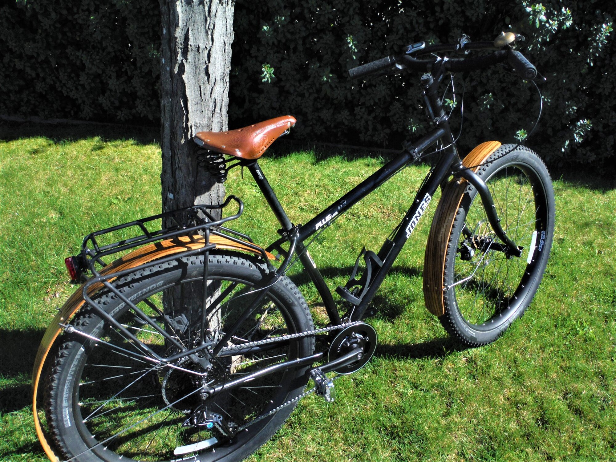

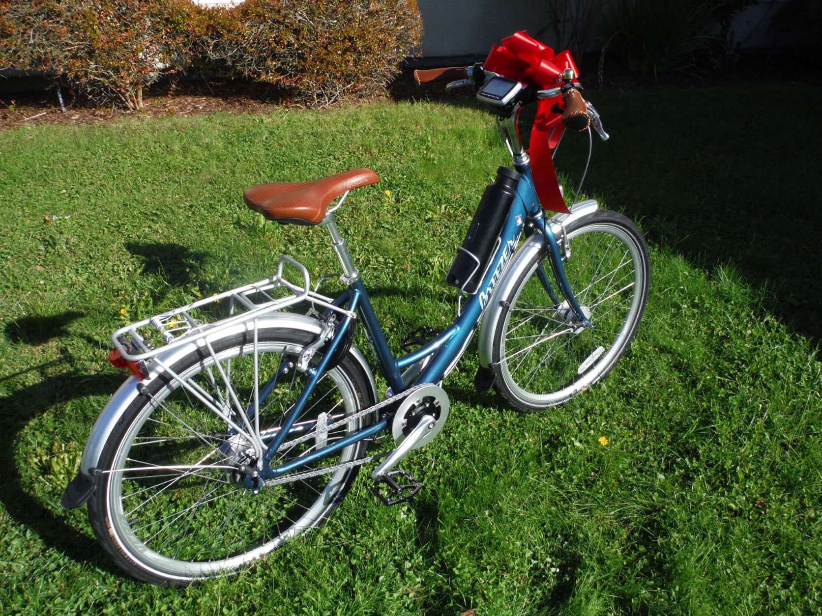

Also, a stem riser with back swept handlebars can totally change the riding position from hunched and stiff to upright and comfy, for like $50 or $60, so don't sweat that piece either. FYI better bikes don't need a thumb throttle, they have foot throttles like in a Tesala, because they measure accelerator pedal pressure and amplify that signal instead of thumb pressure, which is boring. Push Foot, Go. The term is torque sensor. Sometimes I make bikes with both a thumb throttle and a torque sensor. Here is one with an IGH, torque sensor, thumb throttle and Dutch riding position, it has 85 Nm of torque output. About 100 Nm is the far limit before major drivetrain problems. The best bikes do not look clunky and are silky smooth, intuitive to ride.

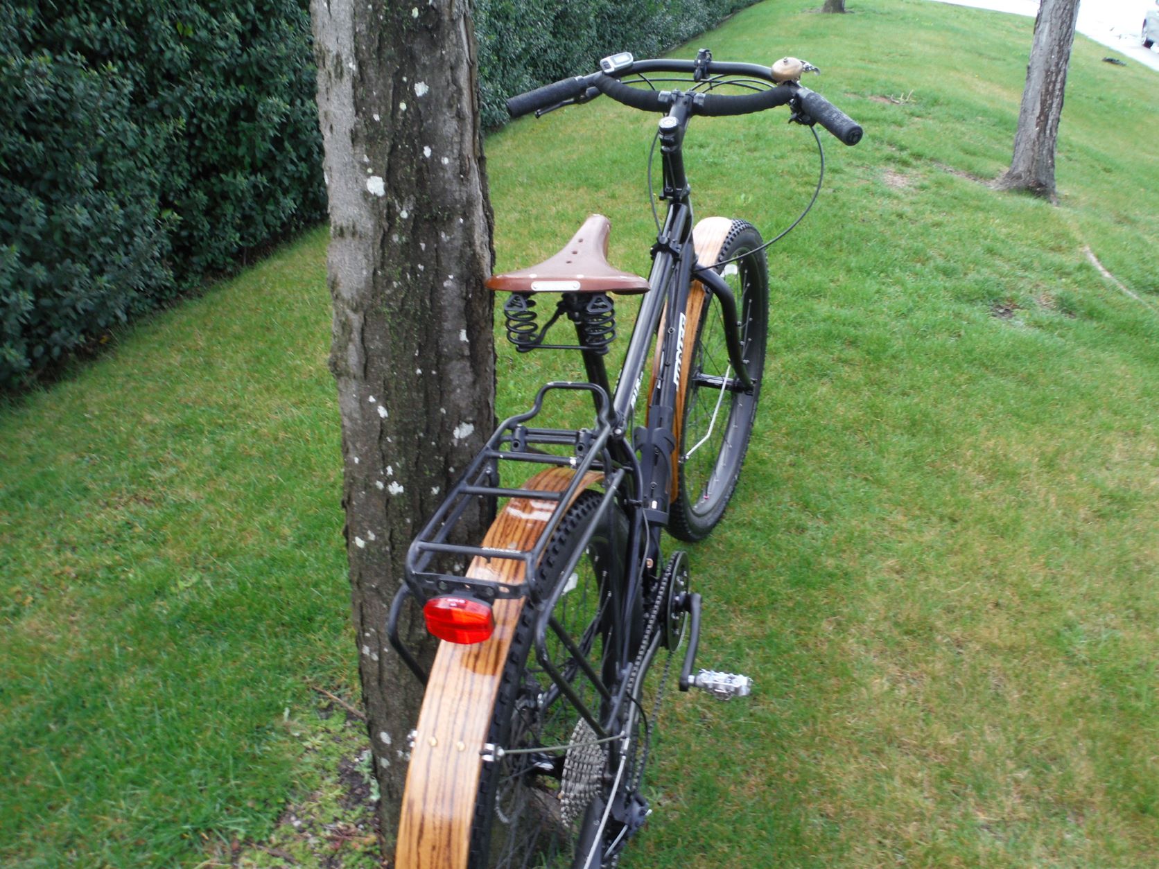

Swearing is highly helpful. I have a pile of powerful wheel magnets for speed sensors. I will often make a slight hook on one end of spare brake cable and make a woven loop at the other end and I will feed it thru-frame, while guiding it with magnets. When I twist the loop, it twists the slight hook the same degree. Once feed, I will build up the cable with fine gauges of heat shrink tube to make it almost at thick as the wire I am pulling. Then I use a larger diameter of heat shrink tube over both the stainless cable and the wire that I am pulling. I will just pull the loop end and I am done. I drilled this bike and went thru-frame when I did the build. If you zoom you can see the battery wire emerging from the back side of the top tube. The display wire emerges from the down tube about 90mm from the right head tube. Don't worry about going back to stock. You will need to do some of this when you upgrade the shifter and derailleur. I am digging the 11-50, Box Three Prime Nine group sets on M600's
