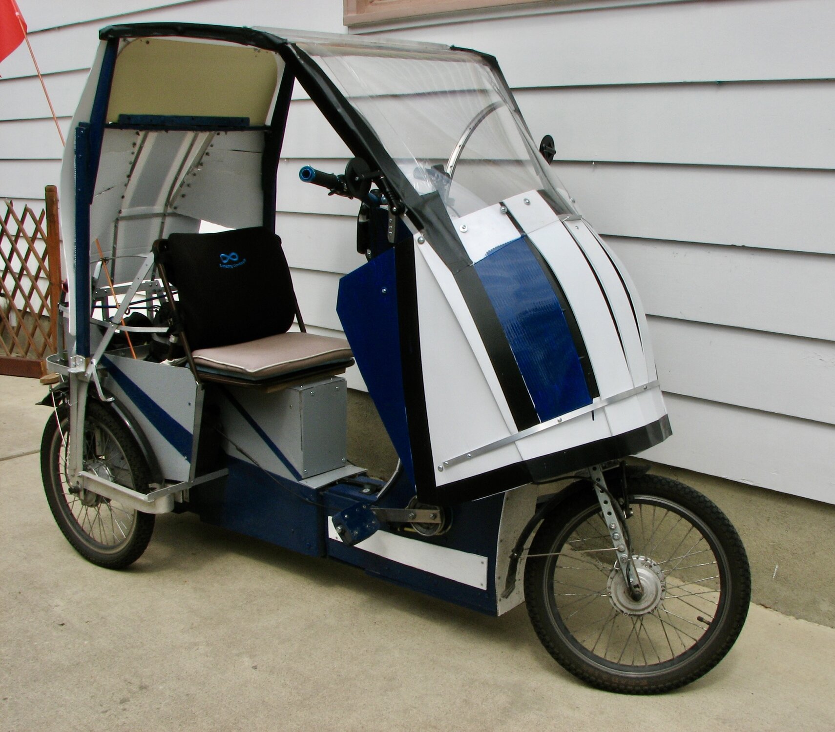

For one of my hybrid scooters pictured in an earlier post I built a canopy for some weather protection.
It is made of a 1.5 mm Lexan sheet as a windshield , some aluminum angles and thin walled corrugated Plaskolite sheets.
The canopy is removable and can be mounted in 15 minutes.
For windy or stormy weather additional Lexan sheets can be added with hinges on the top of the canopy.
They are vertical and protect from the sides and can be folded onto the top of the canopy. Alternatively
flexible transparent tarps can be used for the sides which can be rolled up and stored in the trunk.
Access to the trunk (storage area for groceries) in the rear is by a separate cover which is opened
from the rear.
When pedalling the power level for each wheel can be adjusted from 1 to 5. The pedals do not drive the
rear wheels, there is no chain.It is a hybrid .The pedals work like an exercise bike, but pedalling is optional. If you do
not pedal the power for each wheel is controlled by a throttle, there are three throttles.The throttles
for the rear wheels are operated simultaneously to avoid side pull, but due to a long wheel base and a small
width the side pull is marginally.
The bottom of the vehicle is open but can be closed with additional Plaskolite sheets.

Oh, I had the idea you went on throttle only most of the time since you have 3.
Most of the time I ride with power level 1 for the two rear wheels , that is sufficient for
flat level pathways, if there is a gentle uphill section or a bit of headwind I add the
front wheel with power level 1. For gentle hills I use the front wheel throttle, for steeper
sections I use either the two rear wheel throttles or all three throttles, works great !
