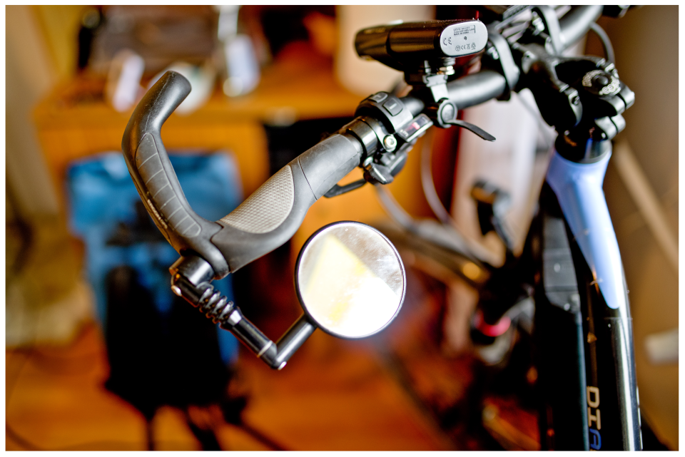

I wonder if anybody knows what is the handlebar inner size on Tesoro X1 Remixte? I'd like install either #1, or #2 mirrors on my bike: 1. https://www.amazon.com/gp/product/B0009R96YK/ref=ox_sc_saved_title_1?smid=ATVPDKIKX0DER&psc=1 and 2. https://www.amazon.com/gp/product/B09C4J8HJJ/ref=ox_sc_saved_image_2?smid=A3SMGSFROZAHND&psc=1
The flat handlebars on your Tesoro Neo X1 Remixte look like standard flat ones, with the clamp area outer diameter of 31.8 mm and the grip area outer diameter of 22.2 mm. I greatly recommend the Mirrycle. Mirrycle is made the way its plug is made of two wedges that will adjust to any inner handlebar diameter from 13.75 to 22.5 mm.
And that is the mounting style that is the best in terms of the total handlebars' width, security, and visibility.
Thx! I ordered left and right , tinted : https://www.amazon.com/gp/product/B094YWYFHF/ref=ppx_yo_dt_b_asin_title_o00_s00?ie=UTF8&psc=1
IF that will not work I will go with the ones I did use before: https://www.amazon.com/Mirrycle-MTB...eywords=mtb+bike+mirror&qid=1643721428&sr=8-6
As you mentioned - they are really work well! Just wanted to give a shot, as being convex, and more horizontal in shape should open more horizontal view.. I also read on the Internet the review and comparison against Mirrycle pointing the wider view available offered by Hafny .. Understand they are bit more expensive, but 20 more may be worth... I will update (for whoever cares) what's my impression as I have Mirrycle on two my other regular bikes, REI's Novaras Metador: https://www.rei.com/product/837480/novara-matador-29er-bike-2014 ... BTW, I did check with Cannondale support stating it will fit.
Hafny is not a bad mirror anyway :) Am I wrong to think Hafnys can only be installed outwards?
