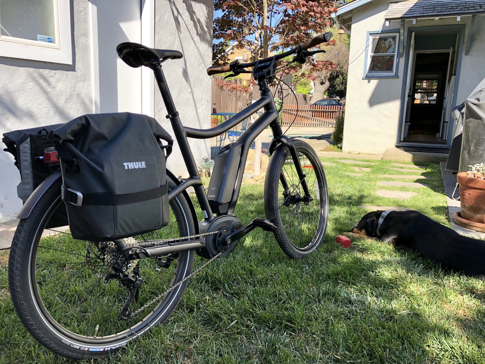

Also a pic of my pannier mod to allow smaller diameter clips to fit. Simple rubber insulated hose clamps mounted offeset to level the tube, and 1/2' aluminum tube from the hardware store. There are surely other ways, but this works for me.

*The rack system. Looks great, but close to no bags fit the 5/8 (16 mm) diameter rails. They have Ortlieb Q3 system mounts, but I already had bags so ended up making a rail system from parts at the hardware store for about $12-15 which mounts to the threaded Ortlieb mounts. It looks stock and is solid. Contact me if you need assistance.

Hi Great photo. May I ask as to why your rear derailleur is so taut?? Is that correct> Holy smokes. Please lengthen your chain. Thanks,
