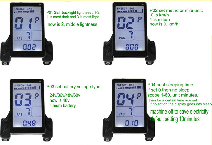

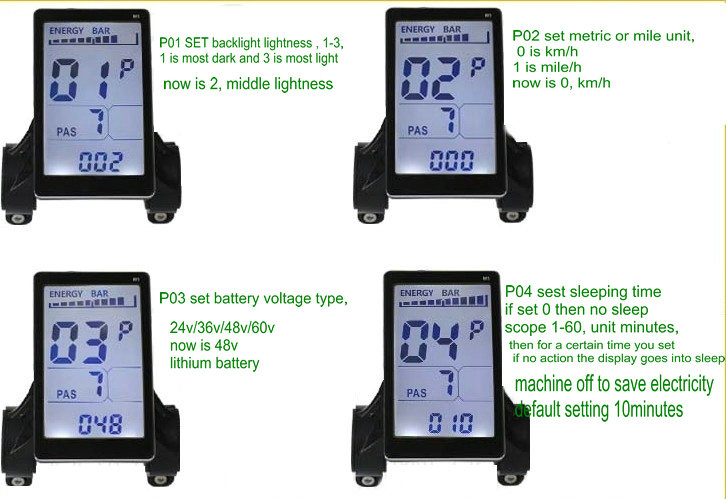

P01 1-3 Screen brightness
P02 1 0=km 1=miles
P03 48V battery size
P04 10 sleep timer

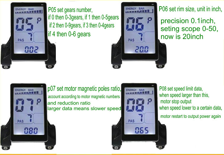

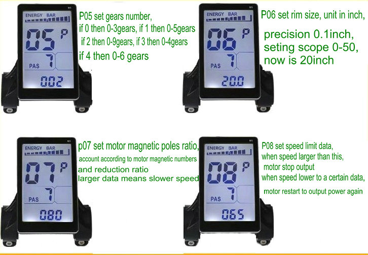

P05 1 Number of gears
P06 22 Tire size (Older bikes came 20 and was changed to correct speedo)

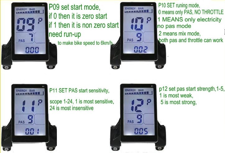

P07 1 Magnetic poles. HIGHER IS SLOWER
P08 30 Stock 45+ To unlock PAS speed limit
P09 0 Throttle on=0 Throttle off= 1
P10 2 0=PAS only, 1= throttle only, 2 both working
P11 3 PAS sensitivity

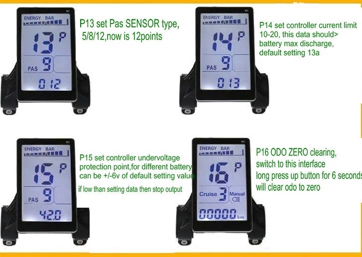

P12 1 PAS strength

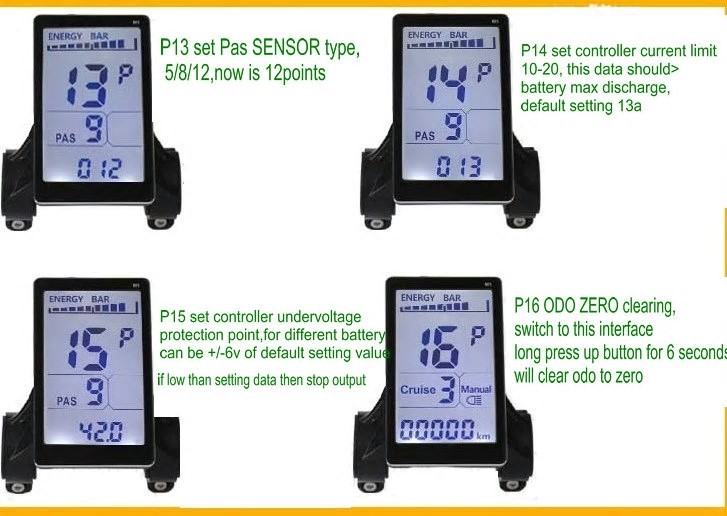

P13 12 PAS Sensor type
P14 18 Current limit
P15 40-41.5V Low power limit
P16 0 Hold up to clear Odo to zero

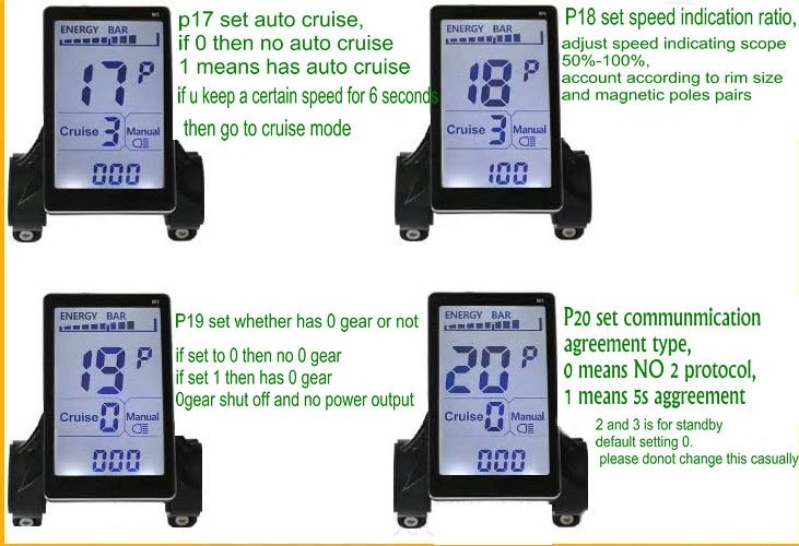

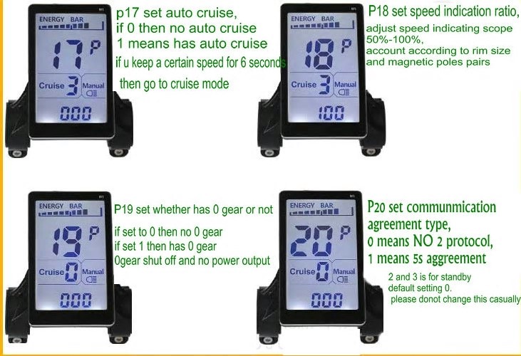

P17 0 auto cruise control.
P18 100% Speed indication ratio
P19 0 Gear
P20 0 Communication protocol
