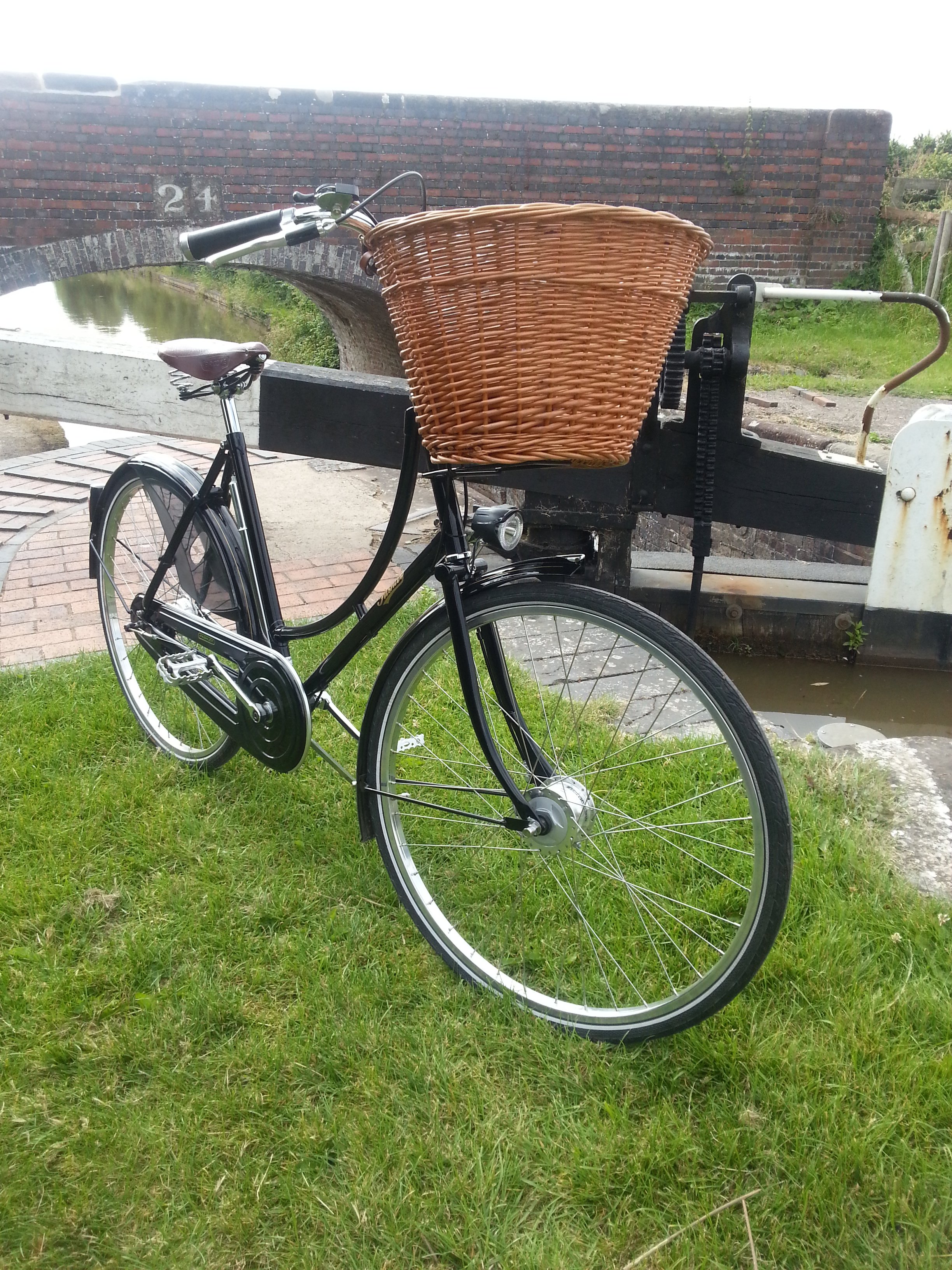

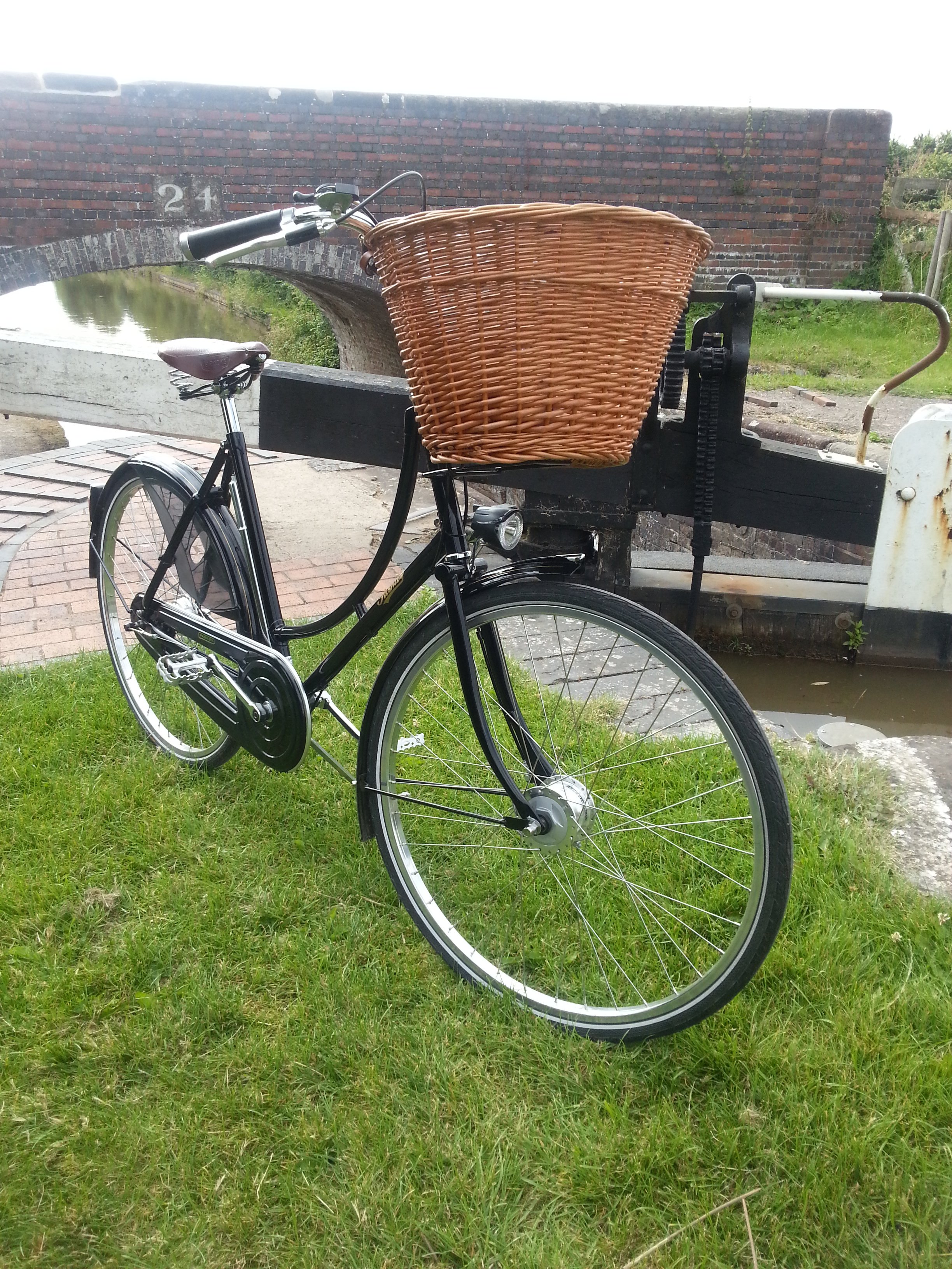

I ordered one those chainring adapters a couple of days ago glad to hear the quality of them is good. Am converting my girlfriends Pashley Princess sovereign to an ebike with the 350w BBS 01 kit I took off my bike. Am hoping this chainring adapter will allow me to fit the fully enclosed chain guard again. Bike is 3spd SA hub with drum brakes she will be using it to commute to work and back. When I completed the bike will post how it went together.
Excellent! I looked for a Pashley for 6 months. I wasn't willing to pay the cost of an imported bike. I made several offers, fell asleep on one that got away on eBay. I rode one two years ago. A marvelously constructed bicycle. Reminiscent of the bike we found in the 50's. High quality welds and excellent finish on a sturdy daily rider. Being disabled makes the step through a perfect bike, but a townie or flat foot, crank forward frame is just as accessible. Her bike will be a perfect combination of bike and motor. My only concern, and being conservative will solve it, is shifting under load. I have a Trek Pure with the same motor and SA with drum brakes, it's important to not shift while the motor is running. Either a tap of the kit brakes or as I do, I seldom if ever shift. Under assistance with the small chainwheel it will be very easy to start in 3rd gear and with that gearing it won't be hard on the motor at all. I have a 48T x 11T townie style that I ride on the flats and never take it out of that gearing, except on ice and snow. I'm about to go the opposite direction and add a 52T. I do wish I could fit the original chain guard on my wife bike, but she likes the gearing as it is 48T with 11TX34T cassette. I'm importing another stock of Bafang Parts this month, the 52T is getting popular with flatland riders.
I ordered one those chainring adapters a couple of days ago glad to hear the quality of them is good. Am converting my girlfriends Pashley sovereign to an ebike with the 350w BBS 01 kit I took off my bike. Am hoping this chainring adapter will allow me to fit the fully enclosed chain guard again. Bike is 3spd SA hub with drum brakes she will be using it to commute to work and back. When I completed the bike will post how it went together.
Sorry, forgot to mention. You saw it comes unpainted? I just did an alcohol wash and a good rub out with coarse steel wool and rattle can painted mine. The finish came out quite nice. The Trek Pure like your Pashley looks better with a chain guard.
Thx Louis the pashley is a nicely made bike we picked it up 2nd hand it had hardly been ridden,there are plenty to chose from over here we only live bout 15 miles from the place they build them.
I will set the rear brake a little slack to facilitate cutting the power for gear shifts I doubt she will change gear much her winter ride to work is almost all downhill or flat, the ride back is uphill with a long sustained climb of a mile plus steep in places.
The standard gearing on the pashley is a touch high so should be about right with motor assist, won't be much point gearing it higher as she does not like riding fast.
In spring and summer her ride is about 20 mins a flat and very pleasent journey along the canal into town centre, with no cars and mostly only other commuters on bikes.
Did think the adapter plate looked bare metal no problem to give it a degrease and spray job, will mount the lithium ion bottle battery onto a rear PDW paydock rack, am looking for a small oblong wicker basket to conceal the battery.
