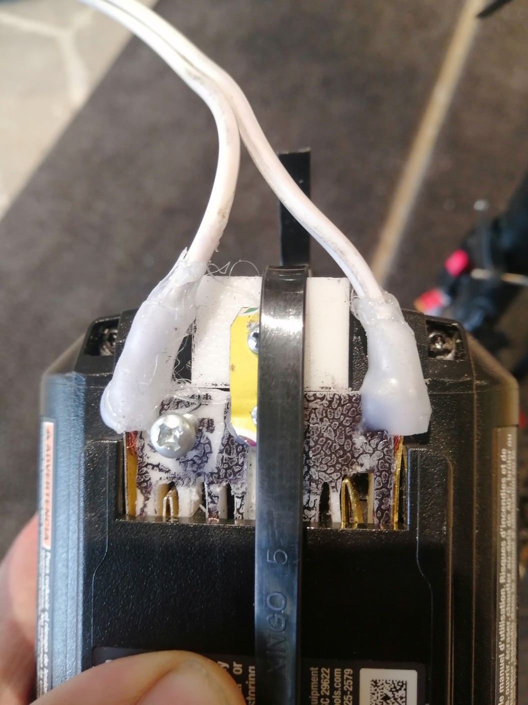

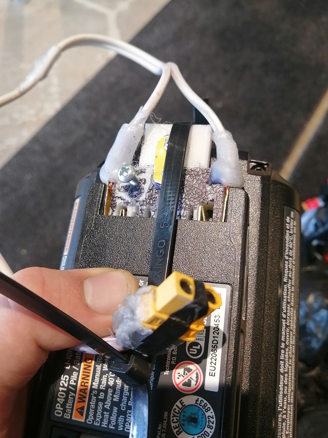

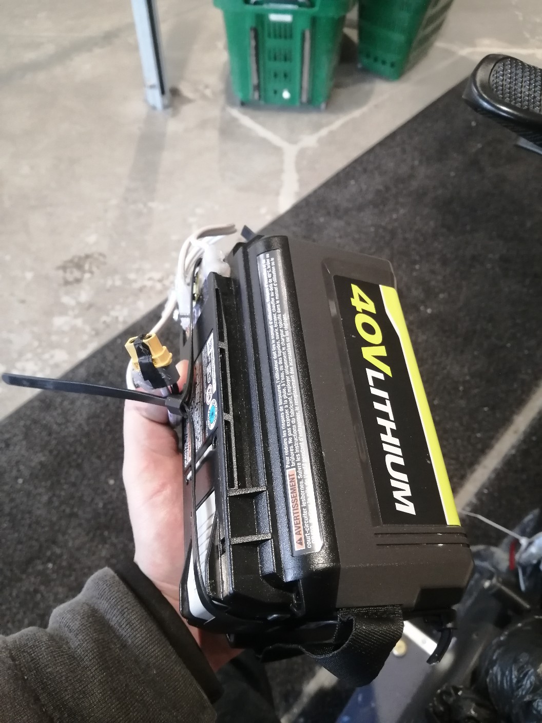

The charger is a cheap Chinese charger rated for 42 volts and 1.5 amps it has a xt60u adapter. Only the positive and negative wires are attached.
I made an adapter that converts Ryobi tool port to xt60 u
I'm tempted to try plugging it in but I'm not sure.

You maybe flirting with trouble.
40v on the Ryobi battery is nominal and you need to know the exact voltage it should be charged to... though 42v is probably correct.
Being even 0.25v too high can make the battery unstable.
I have the factory charger, but it's a pita to unmount charge then remount. If I could charge thu the xt60 connector things would be much simpler
How could my idea start a fire?

Overcharging and charging with no protection.
The reason the tool battery has multiple pins is to allow the charger to protect it during a charge.
