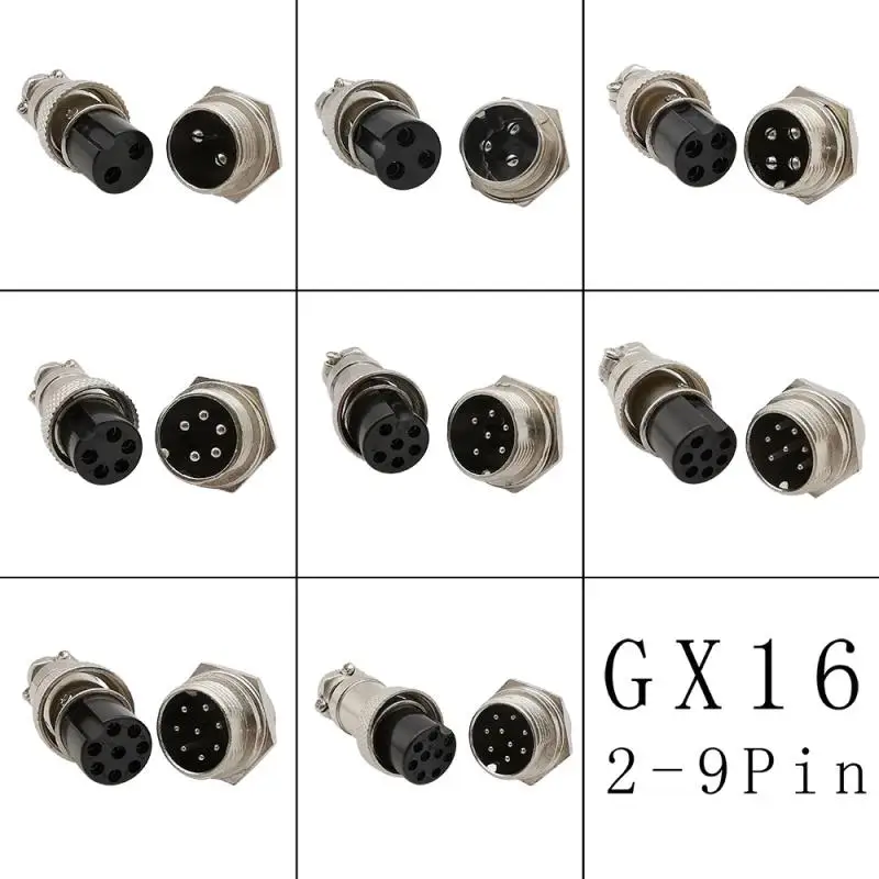

You will need a GX16 connector
And get a 36V pack, with whatever capacity you desire.
