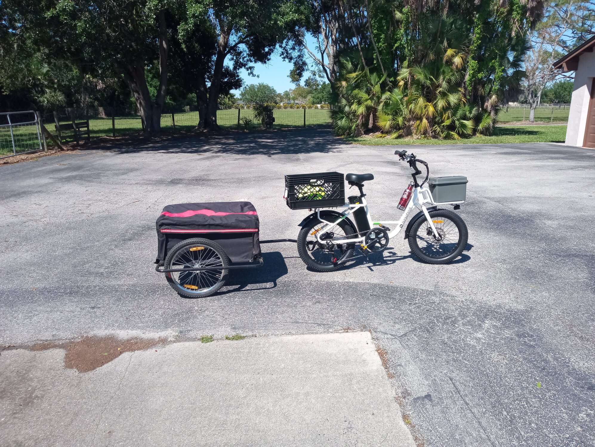

I hooked up a trailer to my new Ebike. Been pulling them for 15 years behind my bicycles, motorcycles and scooters.
Trailer from Amazon and other places
Aosom Bicycle Cargo Trailer, Two-Wheel Bike Luggage Wagon Bicycle Trailer with Removable Cover
