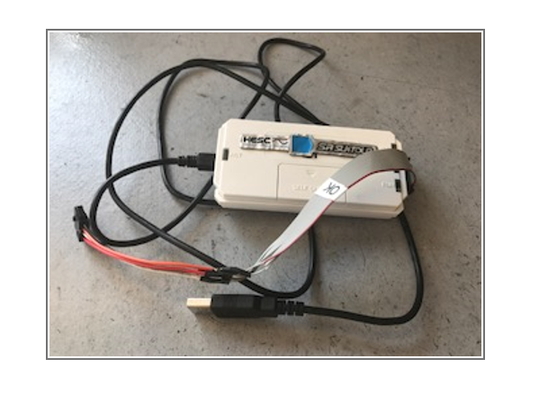

- SR Suntour says that applying an update is possibly with a writing device that you plug on the controller and that it is really easy.
