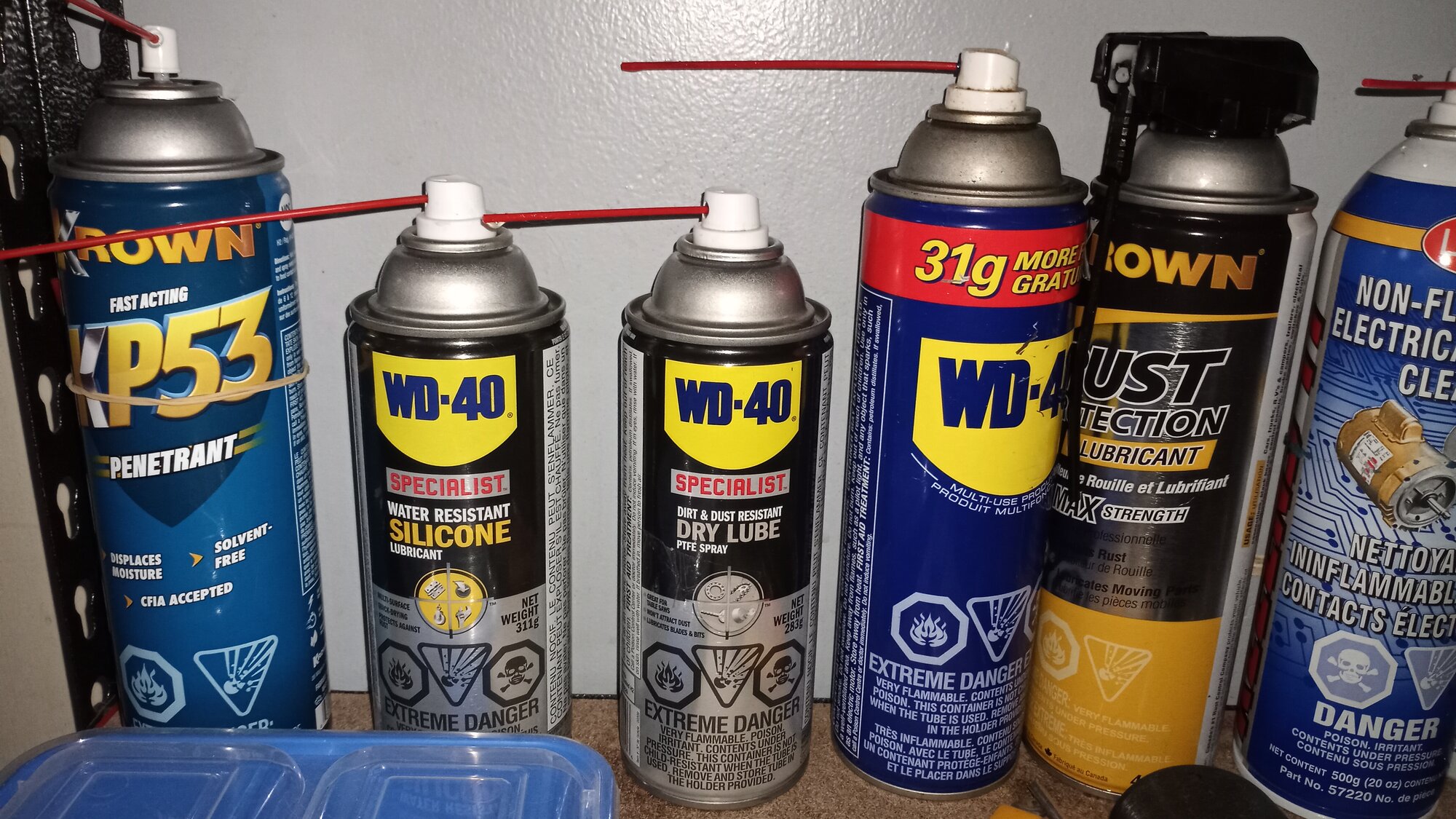

Not regular WD40! There's a Specialty WD40 White Lithium spray that would be good.
TT
Not regular WD40!
I agree ^^^
Regular WD40 evaporates completely and leaves nothing behind.
It works as a penetrating oil for rusted nuts and bolts but that's about it.
TT
Yes... Regular WD40 I find excellent for this as its very light and can actually aid in cleaning.
