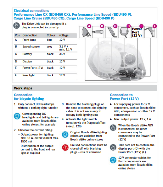

According to Garmin, the Edge Power Mount needs a "Bosch power mount accessory cable" which they state is for the "Bosch eBike system Generation 2". Would this work with my motor? It looks like a different connection to the Smart System motors.
The limitation being it only powers the mount :(
I also found this cable, which I assume is for the non-smart system. I wonder if I could split the power from it to the cameras and the Garmin mount. The Garmin uses a HiGo plug which are relatively easy to obtain. The camera might be more of a hassle being a USB connection I believe.
The cable picture you just posted looks like it might be a smart system headlight cable. I can't tell just from the picture. @AvalancheRun might be able to confirm.
Yes, this will plug into the headlight port on your drive unit. So you would need to unplug either your front or rear light that the R&M comes with to plug the garmin in...

yep because I dont think the power wil do more then 12 watts.
That could be an issue as well. The Edge is 1A and the Garmin external battery can output up to 15 watts. I do not have the specifications for the camera but it is powered via a USB port so I assume similar to the Edge.

Foofer was right about the wattage too. AFAIK none of this info is readily available to us owners.
