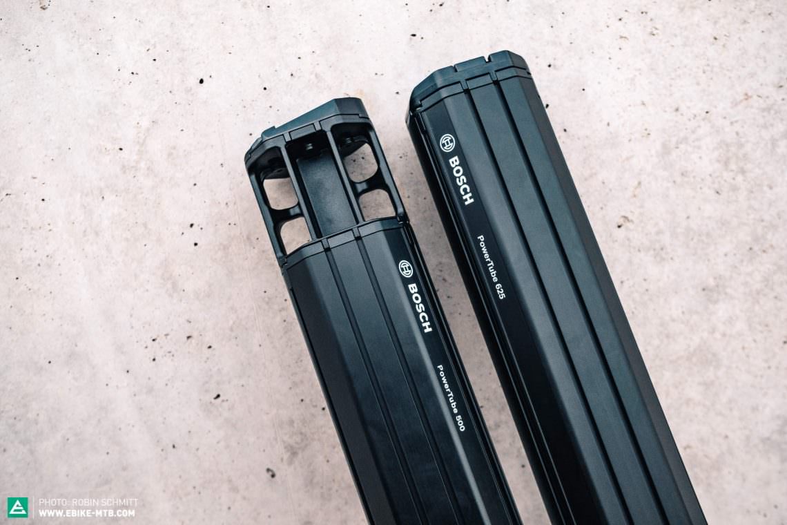

This is correct. The 500, 625, and 750 wh powertubes are all different lengths - Bosch has the dimensions on their site now.

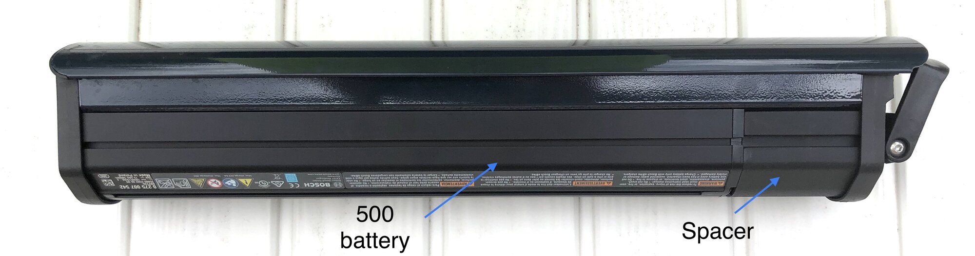

My 500w Powertube mounted to a outer case (or shell) for an Allant +7s sure looks like it has room for a longer battery such as the 625w.

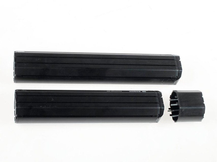

Ah, that explains it. Your Allant's frame was built to hold a 625wh powertube (they sell Allants with both size batteries). So it can fit a 500wh powertube as long as the battery has the spacer on the end which makes it as big as a 625wh powertube.

But if you have a bike built for a 500wh powertube(ie designed before 2019) you're not likely to be able to go bigger.

The following site shows the dimensions, which indicate that the 750 Wh battery is 68 mm longer than the 625 Wh battery. And the 625 Wh battery is 67mm longer than the 500 Wh battery.
The Allant frames support both 500 Wh battery (with a spacer) and 625 Wh battery (with no spacer). Therefore, there is no way a 750Wh battery would fit in the existing Allant (at least not with modifying the frame).
