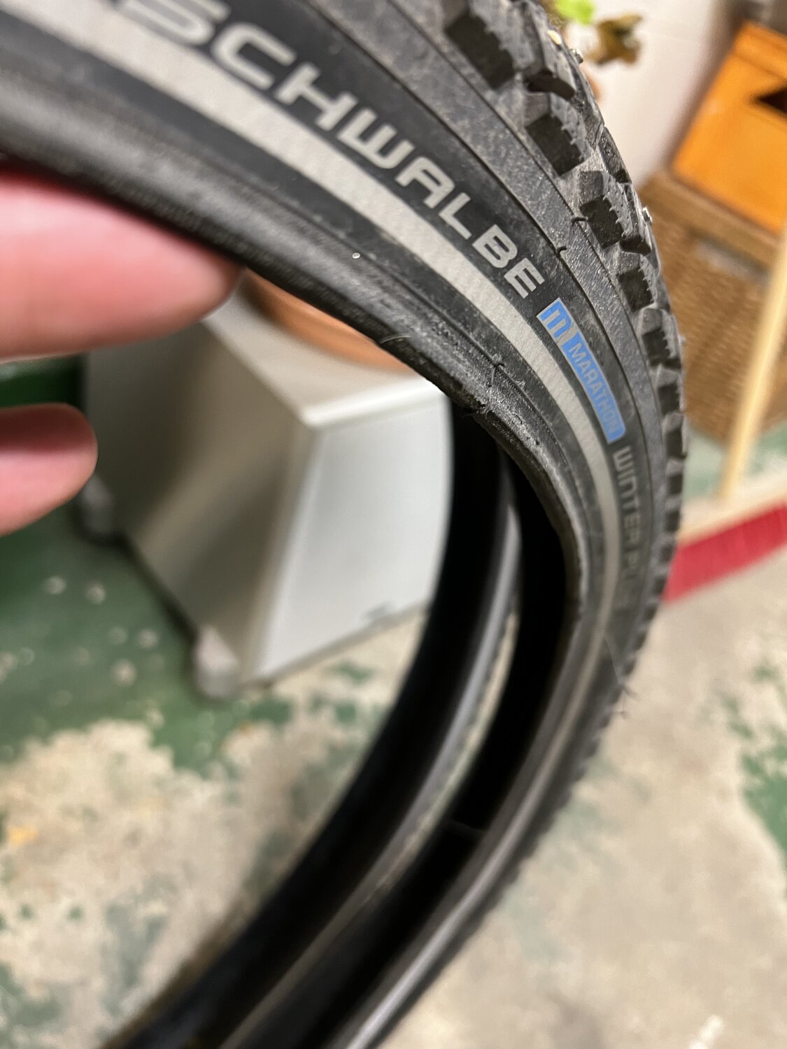

I've gone through the rim and tire, and what I can see is that the bead is quite frizzled at the problem area, you can see the cord at some places. I'll take some pictures and share.
However the LBS that changed it said that this is a tricky rim and that the tire likely still would work on a more forgiving rim, he couldn't answer to the state of the tire and if the blow out was due to that. He was more focused on selling me on a tire from a different manufacturer ;)

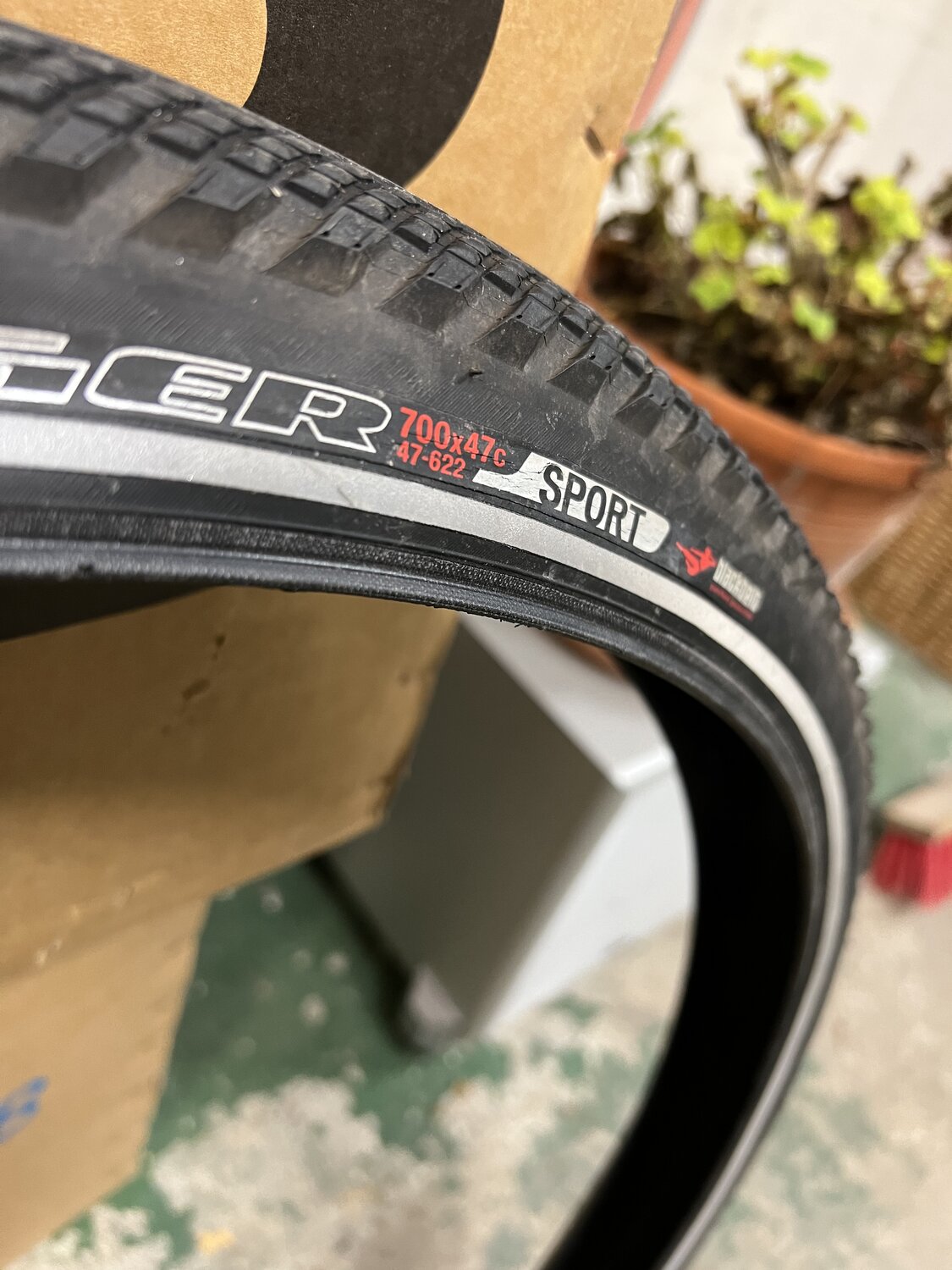

When comparing the Trigger tire with the Schwalbe one it is quite a different profile on the beads. Whilst the Trigger one is like a triangle in profile where a point faces the rim, the Schwalbe one is more rounded, meaning that it doesn't offer as much bite.
Combining that with the very small clearence in the rim it's apparent that it's going to be trickier to seat.
I had to soap it to get it in place, and it does not give that satisfying pop sound when it seats like you get from the Trigger ones.
