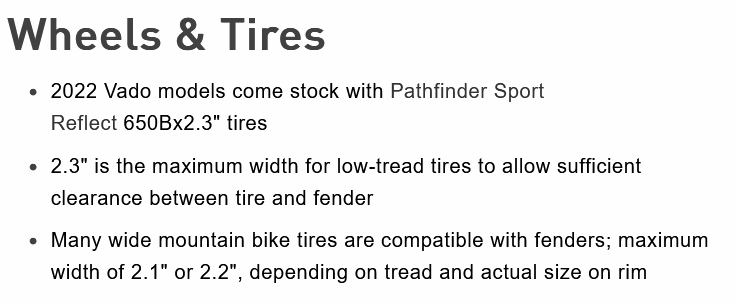

I am gearing up for winter riding, and am wondering what are my limits on tire width for my new Turbo Vado? Stock tires are 2.3's and I'm looking at the 2.6 Schwalbe Ice Spiker Pro. Will they fit? Thanks in advance.
SBC says you need to go down in size with knobbies.
In general aren't stated clearances usually conservative ?
Don't know about 2.6 , maybe a 2.4 ?
