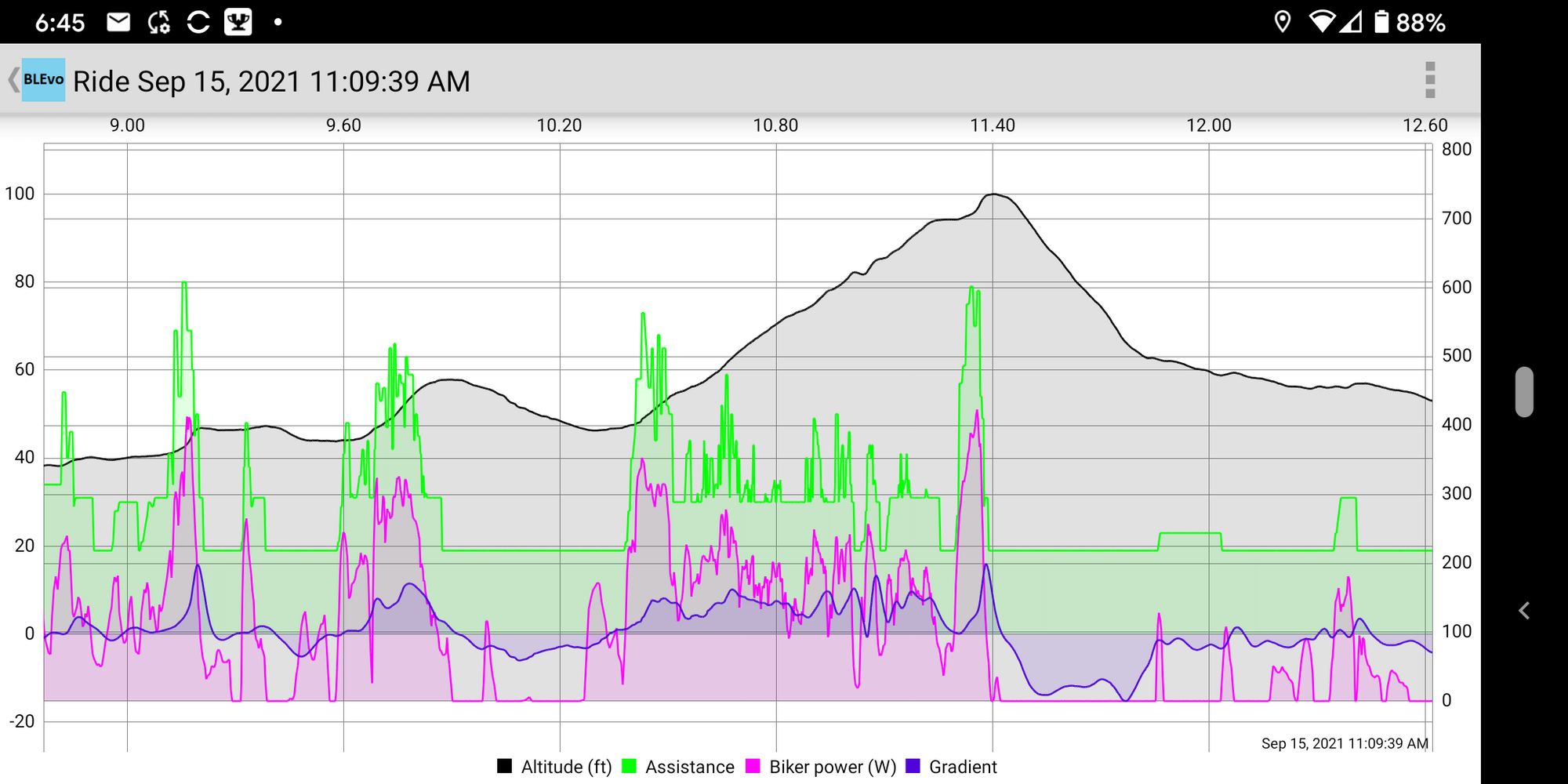

Did a short uphill ride to check out settings with assist acceleration threshold around 100 W, acceleration set to fast and deceleration set to super eco. Climb is about 5% overall with a few >10% bits. Smart power set to eco 19-98W. Overall the assist response was very smooth and the deceleration was also very smooth. Not sure if it saves battery vs just switching between eco/sport/turbo as the gradient increases, but it is fun to play with. Assist and gradient on left axis, power/elevation on right:

Yeah I'm not sure how smart power works either tho I still intend to use it. Currently setting so the threshold is slightly below average power. Then set the +/- tolerance so that I can easily exceed it to boost assistance. This works pretty well in general for uphills and the headwinds (7m/s approx 15 mph) for me. I know the Blevo display lags what is actually going on sometimes. But on an overpass I ride regularly, assistance will boost to 50% or more, my rider power will be 300 W or more but the motor power never maxes out - usually around 200 W instead of 300 W. The overpass is long enough that Blevo should be able to see 300 W * 50% * 1.8 (or 2 depending on what you believe) > 240W max motor power.
I was quite surprised to be able to climb the neighbouring overpass in Smart Power Eco. Normally, I need Turbo to feel comfortable there! Your remarks have been the most helpful!
