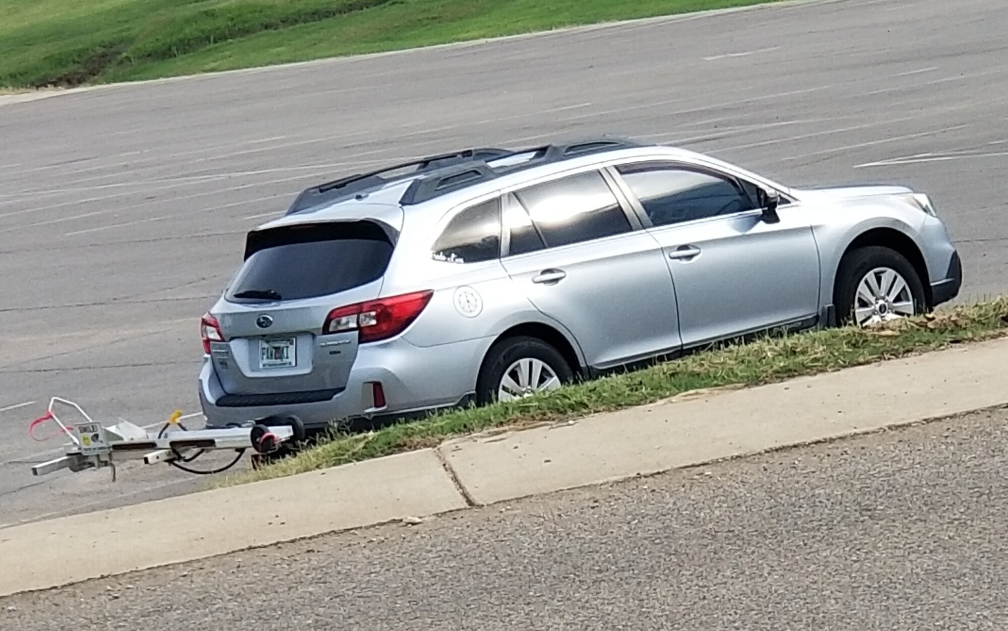

Like I said, etrailer.com. I have a Draw-tite 2” hitch on my Rav4 hybrid, with a Hollywood rack. I haul 2 56lb Trek Allant+7 ebikes for 3 hour trips fairly often at interstate speeds. Best of luck.
discountramps.com has some good heavy duty ramps. I would prefer to over kill it, than to be looking for parts dragged off the back of my wagon.
discountramps.com has some good heavy duty ramps. I would prefer to over kill it, than to be looking for parts dragged off the back of my wagon.View attachment 94789

Here's the good one with the 6' ramp included. Price is unfortunate but $350 for both these days with free shipping is probably as good as it gets. discountramps.com is cheaper but you have to go thru checkout to see how much they want for shipping. The box mine came in was huge so don't hold your breath on that lower price holding up.
And here is the cheaper steel version. these used to be about the price of the alloy racks give or take $20. The $129 price is not complete as you will want to spend another $85 on a decent ramp. The steelie is also something like 10 lbs heavier than the alloy rack. If I had to do it over I'd still do the alloy despite the increased cost today. Picking it up and maneuvering it ... the sucker is over 5 ft wide and I appreciate the weight reduction and its better made to boot.
