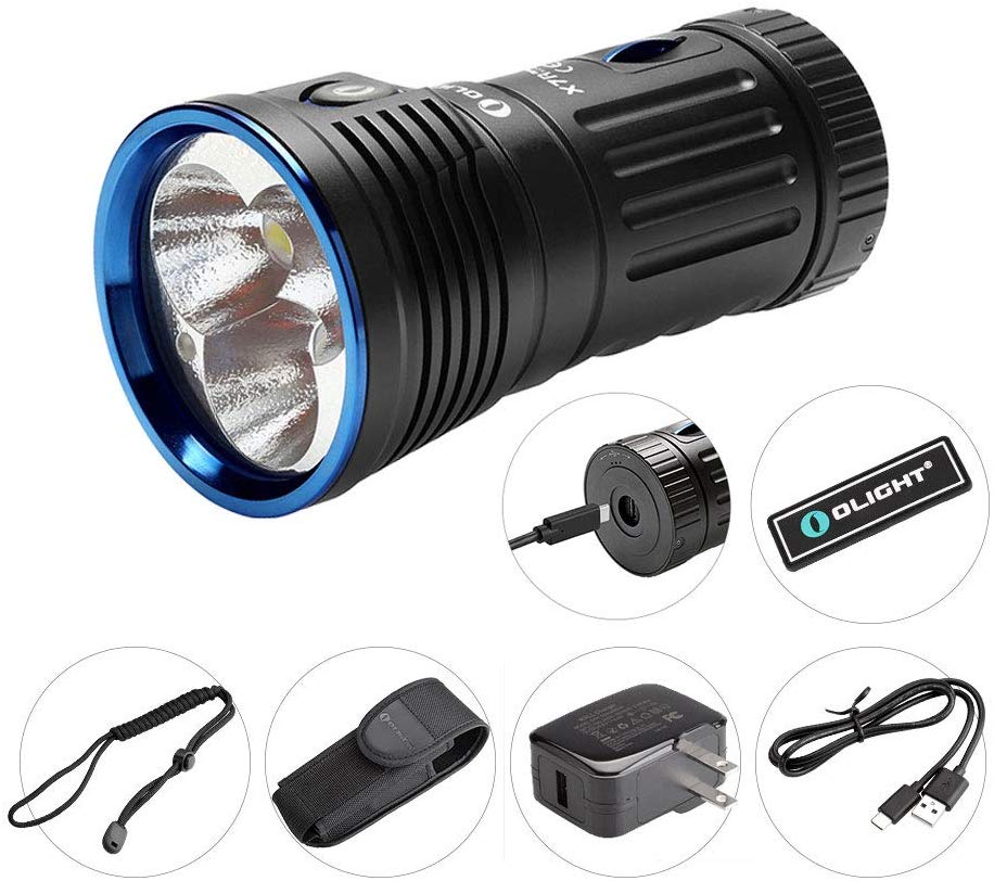

I also prefer to keep the OEM light on my bike for visibility during normal riding. For riding trails at night and especially for tunnel riding, I use a handlebar mounted light with a built in battery. It can be recharged via the USB port on the bike's display. There are many such products out there and they vary widely in price. I use this one from Olight:
It doubles as a handheld floodlight when not on the bike. Since it is a floodlight without a focused beam, it throws a lot of light to the sides which is important on the trail. It has low power settings for use on the road and won't blind oncoming traffic.

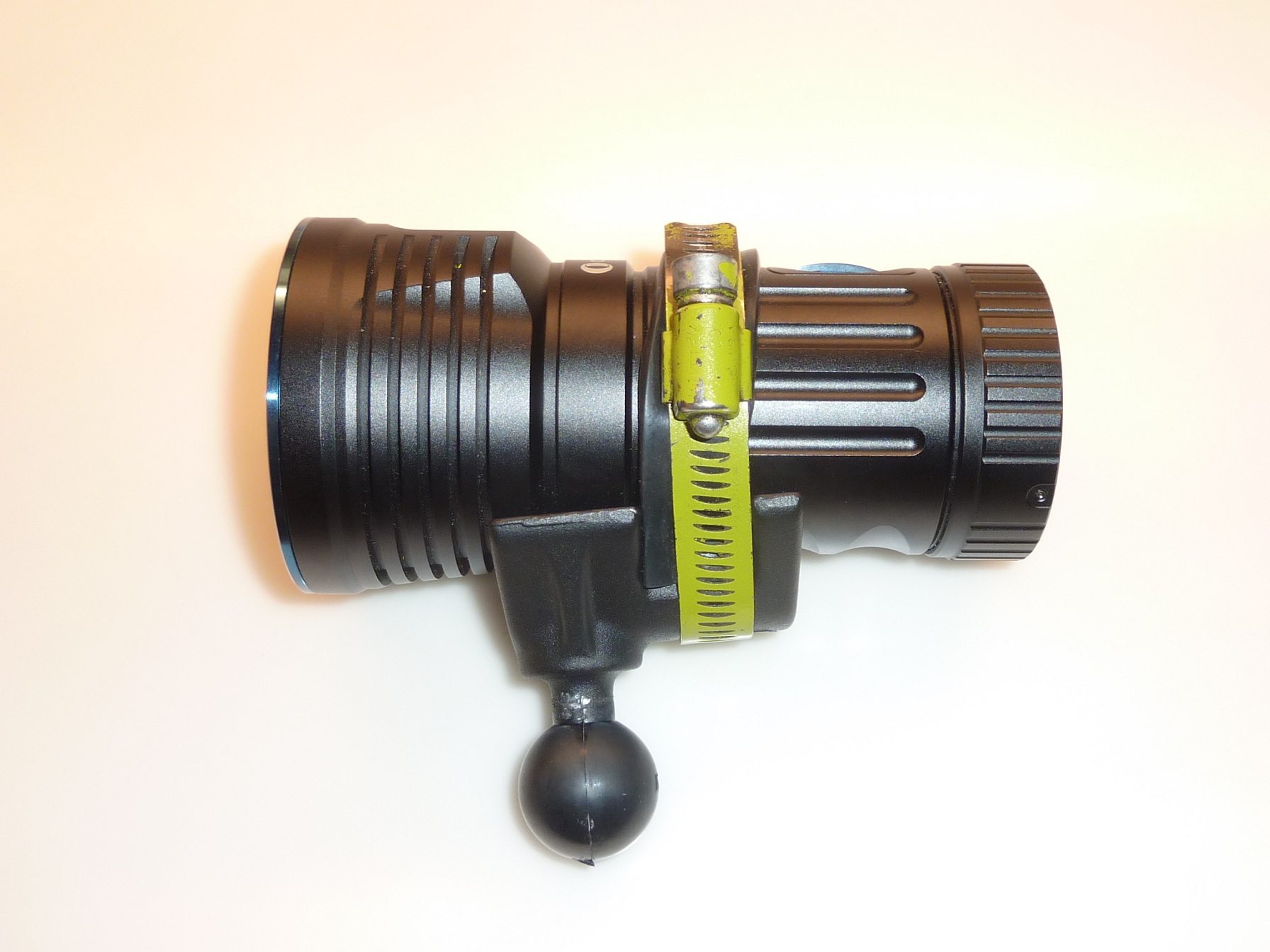

I mount it to the bars with these products from RAM:

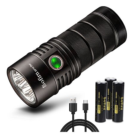

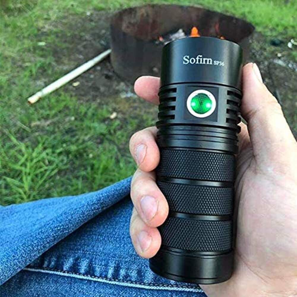

I found an 8000 lumen light off slickdeals and im going to try that out. It might be a little big, if so i can just use it as an emergency/camping light. Anyone has suggestions on mounting it to bike?
edit: the original deal was for amazon link, but you can currently buy it on their website for a bit cheaper but it ships from China so will take 10 to 25 days.
This deal is for the Sofirn SP36 Pro Kit, an 8000 Lumen USB-C Rechargeable Flashlight (IPX8 Waterproof), includes 3 x 18650 batteries and a USB-A-to-USB-C charging cable, and is available through Amazon for $47.99, using PROMO CODE 408C7MHZ at the checkout.
View attachment 102453 View attachment 102454
View attachment 102450 View attachment 102451 View attachment 102452

I just ordered the RAM-B-108BU 2" rail mount to hold the light and i am going to try to see how it works with my current clamp setup i use for my rear camera screen, which i feel has been very secure, that thing was $20 on amazon and can hold a ball of 1" so it should hold the mount well. If it doesn't i will spend the extra money and buy the u bolt or the more expensive c clamp.

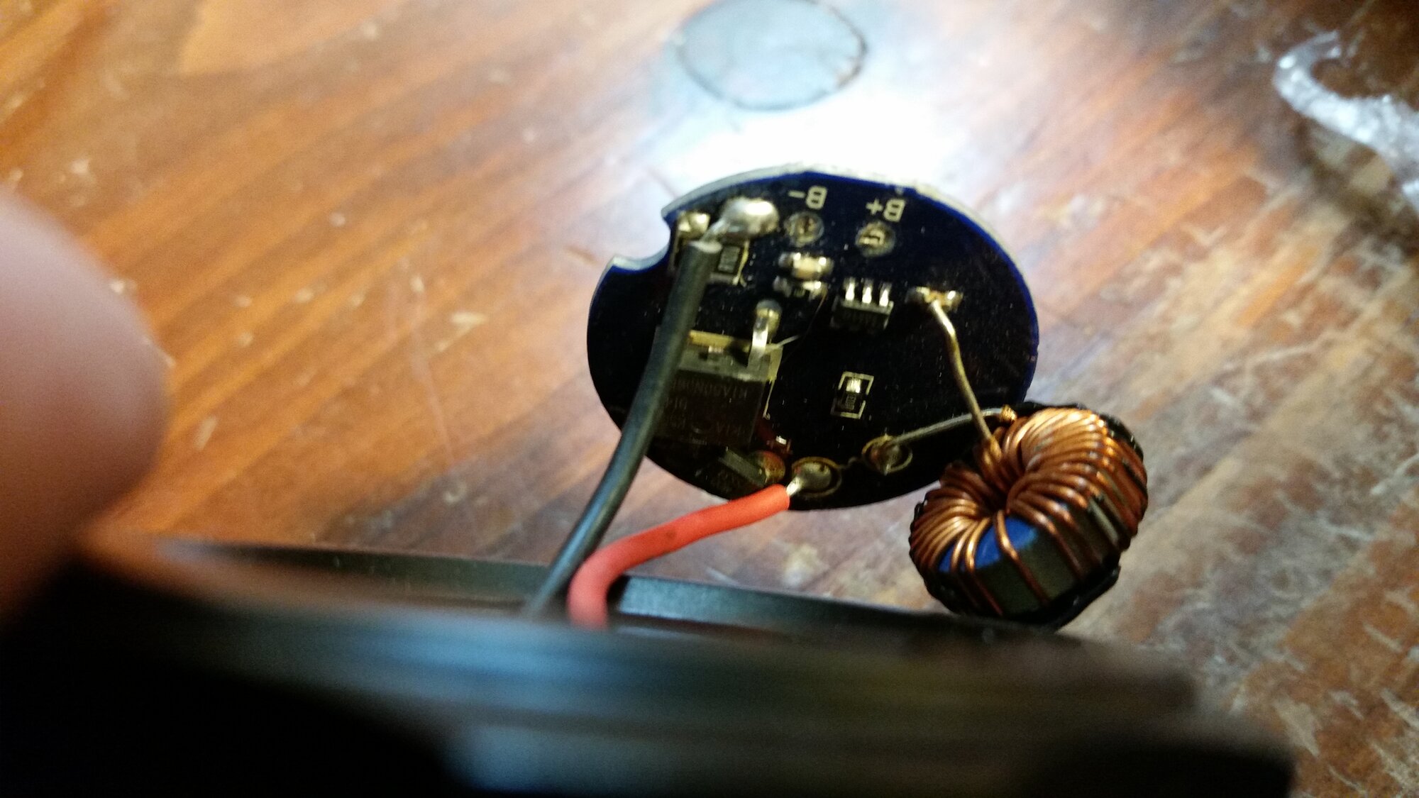

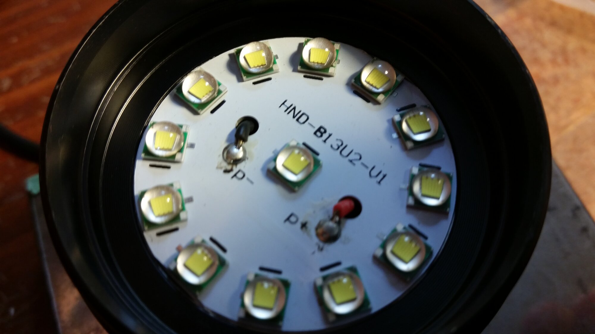

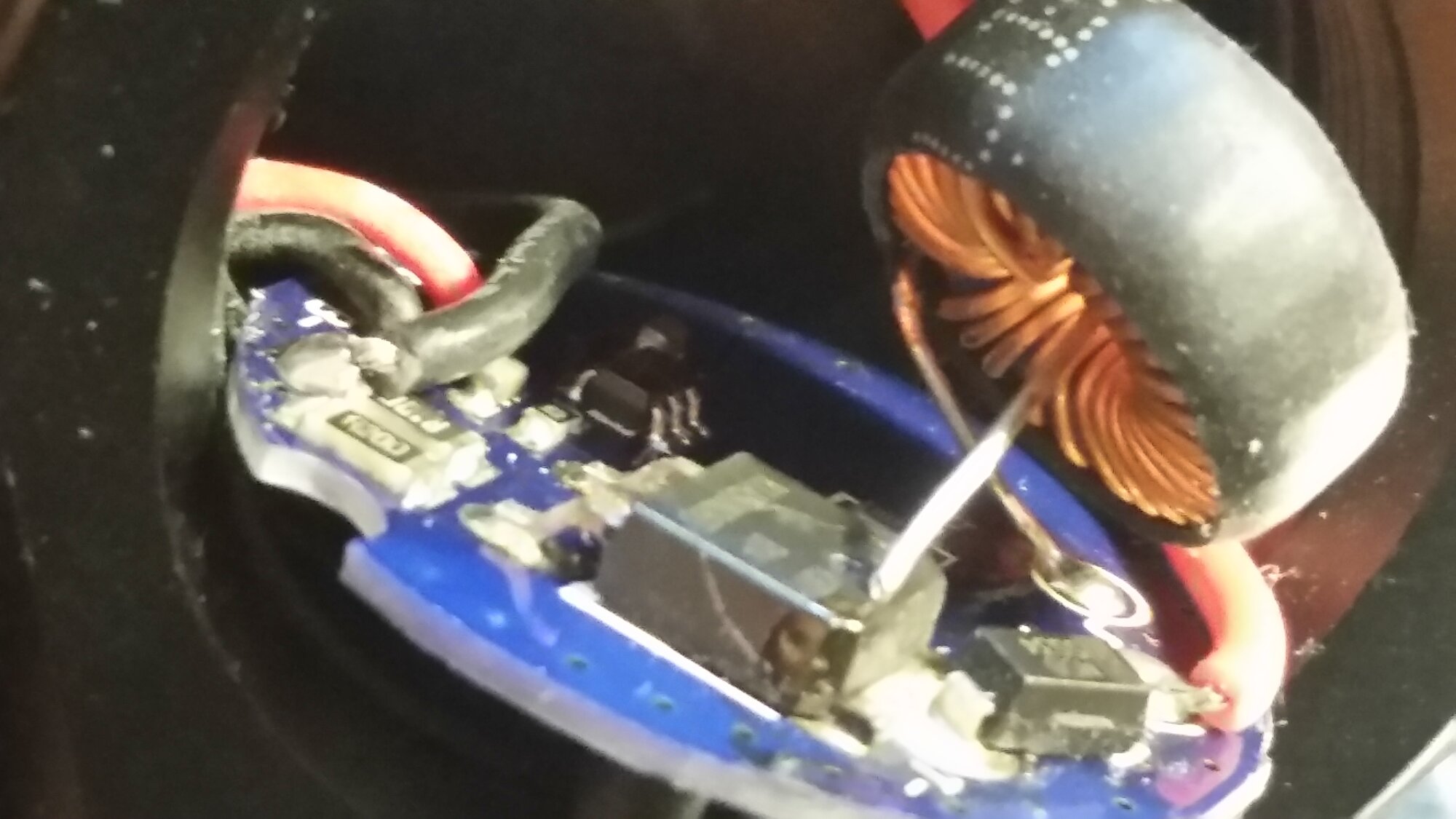

I have a pile of these and we use them. We have 1 or 2 of the big LEDs on all 5 of our E Bikes. They are great for an e bike but you need to look at the discussion Indian Joe and I are having. There are pics of the part that breaks. They did last about 6 months before the vibration broke the (choke? ferrite toroid?). They are really bright and with the 6cell pack they last 45min. My wife rides with two battery packs (sometimes 3) every night of the spring, summer and fall. I also have the first version you showed... the 3 diode light. They have the same doughnut wrapped with wire that will eventually break off. As to light its 3 diodes instead of ten or thirteen. 3 is good 10 is better for an E Bike. I am looking at trying to power these (the bigger LED (13 diodes) with my main battery. I did just buy lights that say motorcycle that run on 12v and have 4 diodes (Wupp brand) then I will get a power converter to take 60v (58) and step it to 12v. Indian Joe says the power stepper (a power converter is called a buck) on amazon for $25 wont last but I might try it anyway. It's rated 25A 300watts called Pro Chaser. The title of the discussion between Joe and I is "Lighting Woes." The second pic shows the Wire wrap (choke?) broken off it's sitting on the black (resistor?) Third pic is one not broken but with it's power wires pulled off. They should be attached to the driver in green.
All things considered These throw more light than anything else I've ever used. We have 5 18650 4cell flashlights called "Sky Ray" they are the same unit as shown above (the 13 diode led) but the batteries are inside and not powered by a pack. We have dropped them each 25-50 times and they all still work. Ebay $20. about three years ago. I dont know why the units made for the bike don't last as long. must be the vibration. Do no buy 18650 Batteries off amazon or ebay. They sell garbage and claim power that does not exist. 3500-4000mah is the upper limit for one 18650 cell right now. I've seen chineese cells claim 9999mah. cant happen does not exist. Read about fake batteries at battery bros. they lay it all out. I can tell you the Three stores I will buy from in the usa but don't want to get in trouble here by posting without knowing if it's allowed. I do love 18650 lithium Ion cells. Most E Bike batt packs have them inside.
