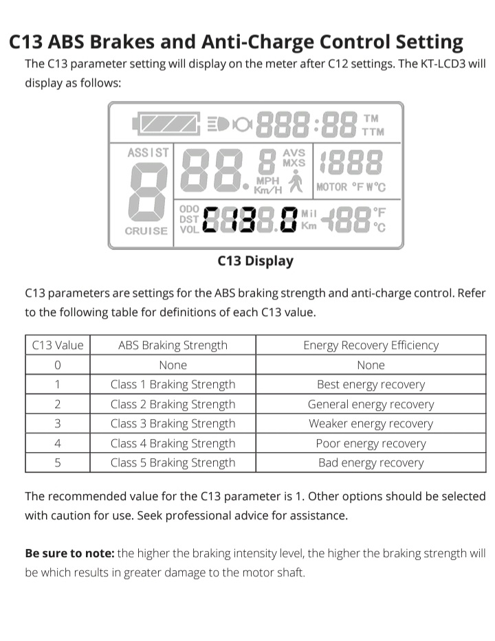

A KT controller allows you to choose between 5 levels of energy recovery.
The better the energy recovery, the harder you have to pedal.

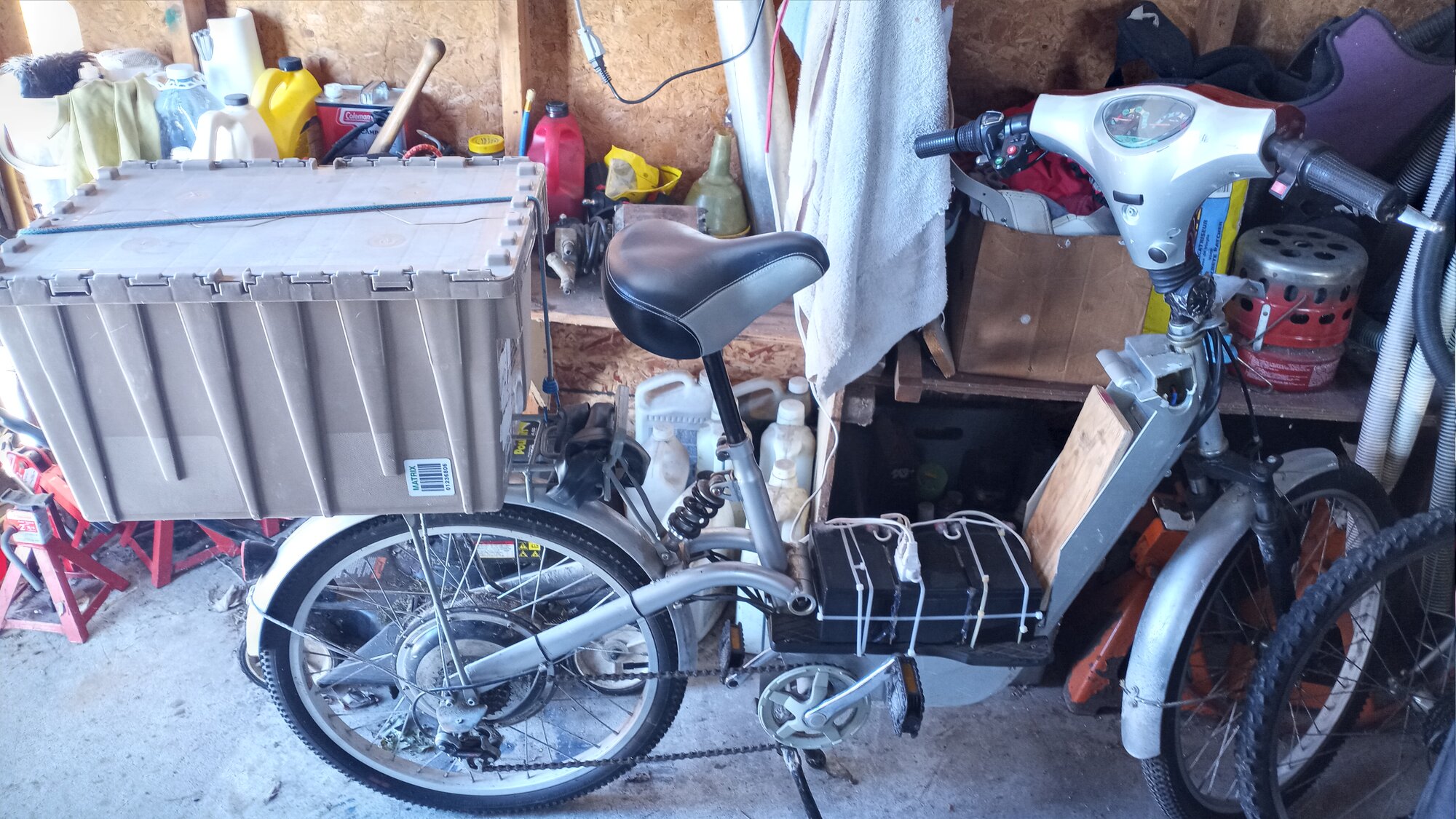

My old e-bike does that.
If I pull a brake lever just enough to activate the brake switch, it activates regeneration and you can feel it kick in.
I like the way it works. Instead of wasting all my momentum as heat on the brake pads, it goes back into the battery.
I can see my voltmeter climb to over 40 volts during regeneration.
The e-bike is fully locked to 25 kph, and the motor cuts out at 22 kph.
As soon as I hit 25 kph, the regeneration automatically kicks in and it will not go any faster.
That's when it gets REALLY HARD to pedal. Not only am I fighting wind resistance to go 25, but I'm also charging the battery at probably maximum power.
So I know that a regenerating e-bike can definitely recharge a battery.

If you bought a KT controller and used a trainer, you could set your regeneration amount to what your comfortable with.
It looks like that for a 250 Watt motor you can set regeneration at 0, 50, 100, 150, 200, and 250 Watts?

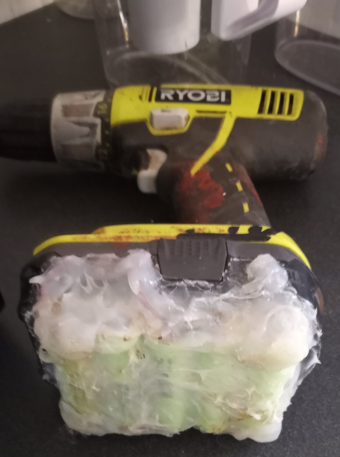

I did manage to double the capacity of one of my batteries by adding 5 cells to it.
They wanted $120 for a single high capacity battery.
