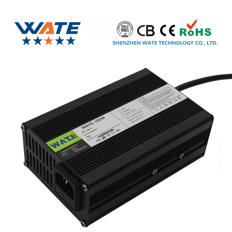

So I bought a charger with a fan from Aliexpress. (took forever to show up paid around 60) The connector looks exactly like the charger that came with my Espin Sport. The info on each charger seem almost the same with the difference being the new charger is a 4A output vs the 2A on the stock unit. Maybe I just answered my own question-will the Sport not work with a 4a charger? When I plug in the 4a and connect to Sport I get nothing. Supposedly the fan is supposed to kick in...
Try turning your battery on to charge. Some chargers pulse on startup and wake the BMS so it will accept the charge. Others do not so you have to wake it up manually by turning the battery on. Once it starts charging you can turn the battery off.
and yea, voltage too, there's a little red switch thing
Yeah, it was originally set to 220 so I switched it to 110 and tried again. The instructions say that when plugged in the fan will come on. I could not get the fan to come on at 110 or 220. I guess I should monkey with it a little more...
Ding, ding ding, we have a winner. Thanks Rocket. I plugged it back in with the battery on, the 2 red lights came on and the fan started working. I think it is charging. Many thanks to you and the guys above that chipped in with the info. It takes a village and sometimes my girlfriend hints I'm the village idiot!
