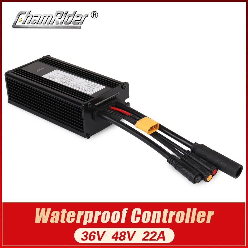

For the controller
again because water proof but again unsure whether would suit bike, as original control box has 5 times as many connections and unsure about sinewave, , thinking
better to buy replacement of original control box and better seal the control box? Any suggestions how with thanks.

If your fat bike has 175mm wide axle in the rear, you want the same type of motor. Here's a typical kit, but the connector is not waterproof.
I've been looking for a water system myself, and they're hard to find as a kit. Your suggestion is a good find, but you will have to buy the cable harness, as well as the brakes, throttle, PAS sensor. Won't be cheap.
That would mean that you would not use any of the electrical bits that came in the kit.
Maybe you look for a bare motor like this, and ask them how much it will cost with a 26x4 rim and spokes.

By the way, that waterproof controller kit is overpriced. You might look some more or ask one of the other vendors to quote a price with those connectors.
