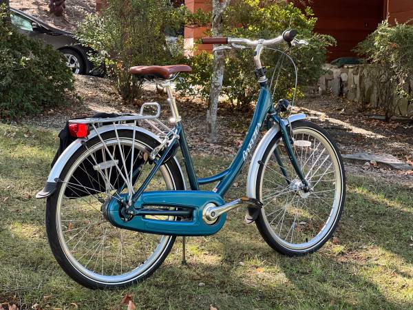

Thanks everyone. I learned a lot reading this thread so now I will take that as an input and feed it into a bike. I picked up the ideal donner bike today. It is a low-step with strong wheels, and internal gears for low maintenance. The riding position is upright and its overall weight will be under 40 pounds. I like small displays and do not like throttles but this bike is not for me. Older people want to be able to see a display and tend to want throttles. I replaced a small display with a large one for a rider today who is in her late 80's. Here is what the donner bike looks like before the transformation. Yes, that is a built in lock and dynamo light system. Thanks again.
I am almost done with the 'adult' bike based on this thread. I purchased it on Thursday and it found a home on Sunday. It will be ready today. The grips are thickly padded and @AHicks advised using a light touch MicroShift shifter for the Nexus inter 8 internally geared hub instead of a twist shifter that is harder to work with arthritis or gloves. I will post a photo when it is done and look forward to comments and advice regarding what I can do better next time to better get it right.
