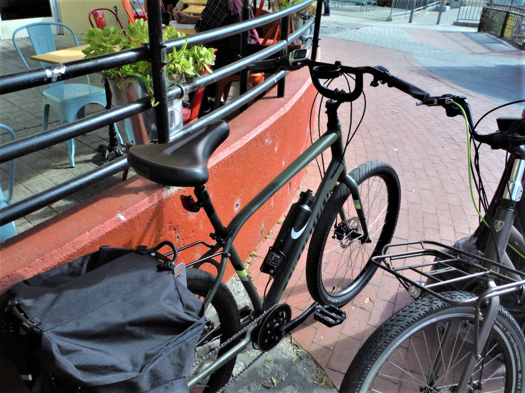

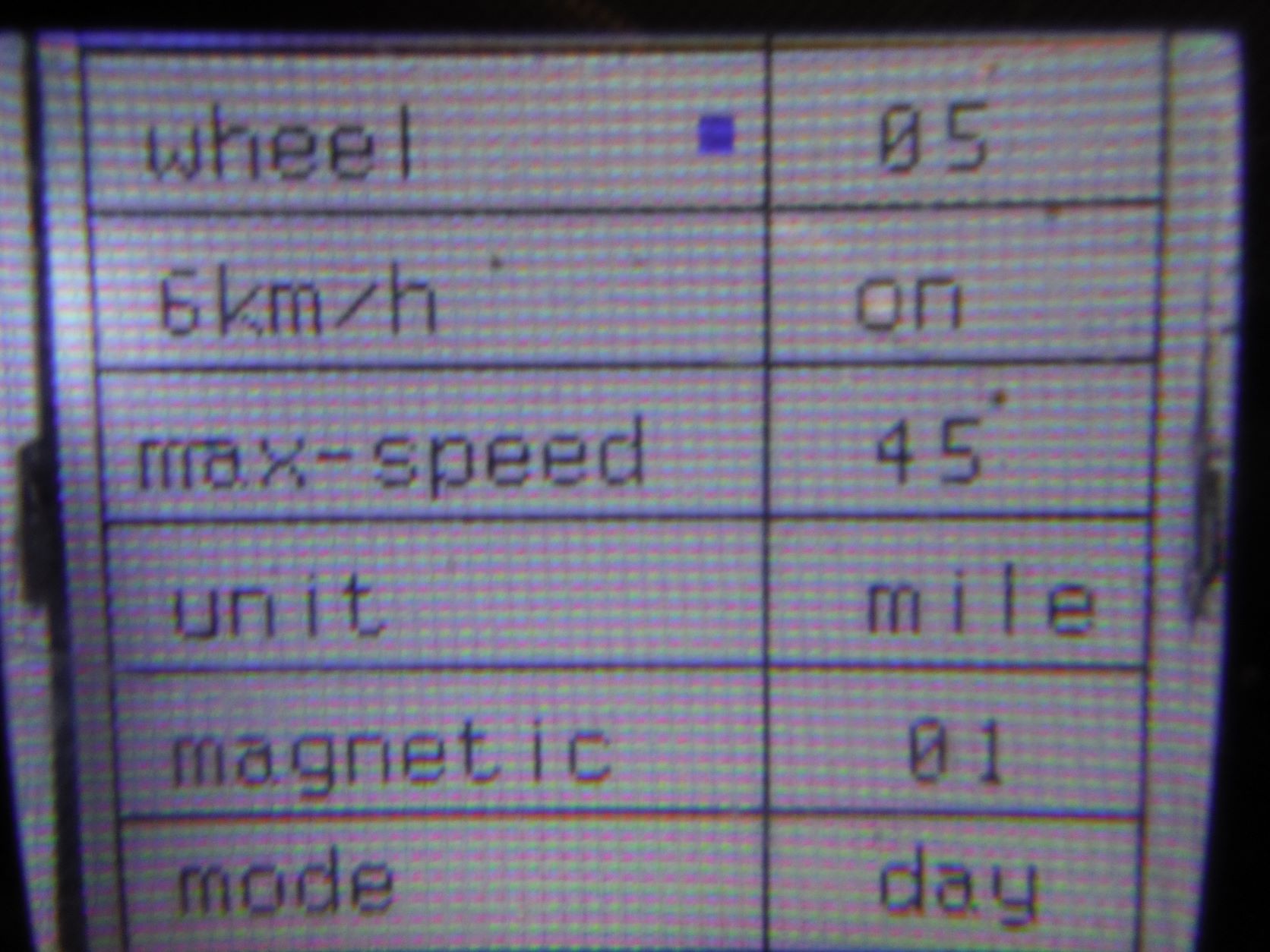

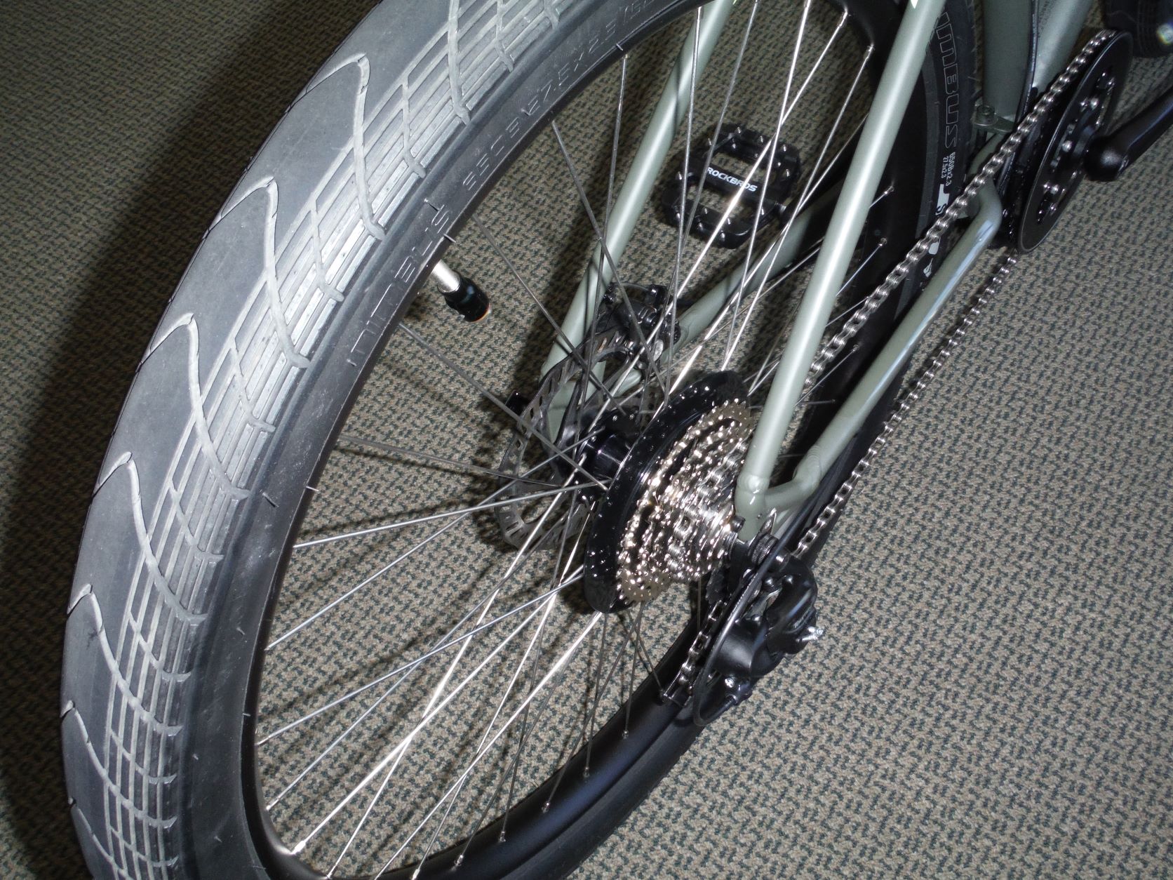

I am putting a seven speed 11-34 on a Specialized Roll mid-drive today. And an 8 on a Garry Fisher tomorrow. That way I can use a much stronger chain. It is for a commuter bike. It must be dependable. Also the parts are not only stronger but also much less expensive. The Supper Moto-X tires for it are on the way. Along with the Green Guard, it is getting tire liners and Stan's because the guy cannot afford to be late to work. I think it is a good looking bike. I set the speed limit to 45 and told it that it has 5 inch wheels. He will always have a spare quicklink in the bag. It rides like a Como. Zero zip ties.

Put a SRAM XD hub on it, shimano HG aren't fit for the job, most of the slippage issues are hub-cassette intefacing issues, an XD hub/cassette combo eradicates those problems.
At this point, I don't want to swap out the rear hub, although that is certainly a possibility if I don't get it sorted. Inteestingly, the spokes are not loosening excessively, although one might expect that they would.
Ward
It's the hub. You're caught in a circle jerk here, blathering on about chains....... it's shimano hg hubs. The 'loose' cogs ie not attached to the spider, slip under high torque, high load scenarios, it usually manifests in the mid to high gears, this is due to the height of the splines on the hub body, it doesn't lock the cassette in tight enough or as one fixed unit, plus the tolerances between the two are always off, so when you put lots of torque through ~4mm (the width of a single cog interfacing with the hub) it slips to the next spline/s.
SRAM XD don't have this problem as the whole cassette screws into the actual hub body thereby transfering the torque directly into the hub, there is no way for the cassette to slip.
I used to use box prime 9 drivetrains, both my bikes now run SRAM X01 mech and shifter with GX cassettes, difference is huge.
I ride proper emtb, very hard and it's extemely demanding on my bikes, i've been through all the slippage kerfuffle, most of the oldies on here don't hammer their bikes and are speaking from others anecdotes.
