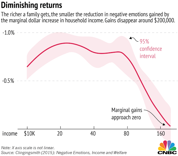

If it's any consolation, a couple of high profile studies point to diminishing returns when it comes to wealth and happiness. Much like the benefits of high end bike components like deureiliers. Boom! Full circle.

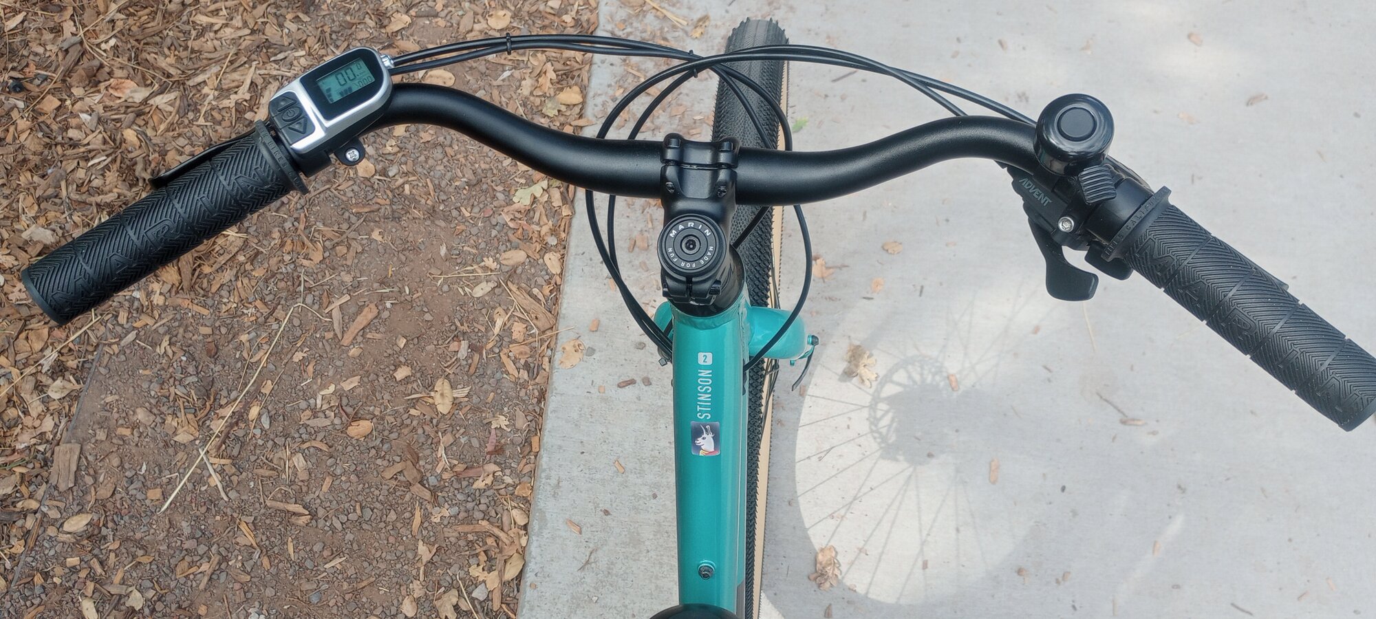

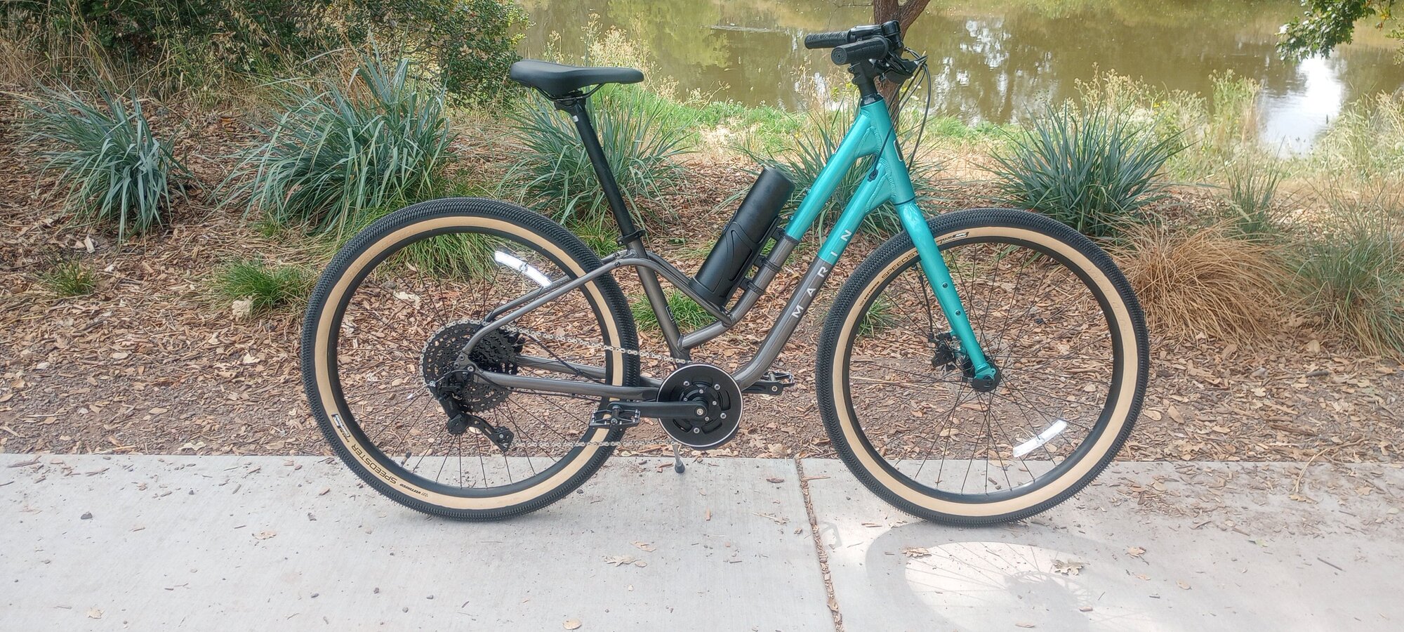

@Rome, Check out the Box Three, Prime 9 Group Set. The 9-speed allows for a thicker chain and more robust cogs with the same overall range as a skinny 12-sp. I just installed an 11-50 Box cassette. It will climb any road that a car can drive up a mountain. That bike is a 'ladies' Marin Stinson 2 ST, step-through, version of a modern take on the classic beach cruiser. My metallic blue mid-step Marin Stinson (Beach) 2 XL arrives tomorrow. This is exactly what a 90 Nm eBike looks like! That bike is so fun. Smooth, Intuitive! I had to ride it 12 miles today to bed the multi-metallic bronze pads to the stainless rotors. There are other sellers who price match, I just saw the $212 set on sale in 11-46 for $140. Use premium housing and a premium Bontrager pre-stretched and highly polished shift cable. Put gun oil down your housing. That 'girl's' cruiser will kick the adze of any Specialized product on the market in the real world. It has a cargo motor and comes in at 40 pounds. No Spandex required. It will, Smoke every mountain, search far and wide, pee in every fountain, till you find two Vados. Then you will smoke those and put them in the ash can. Note: An adze is a tool used to make things such as canoes.
