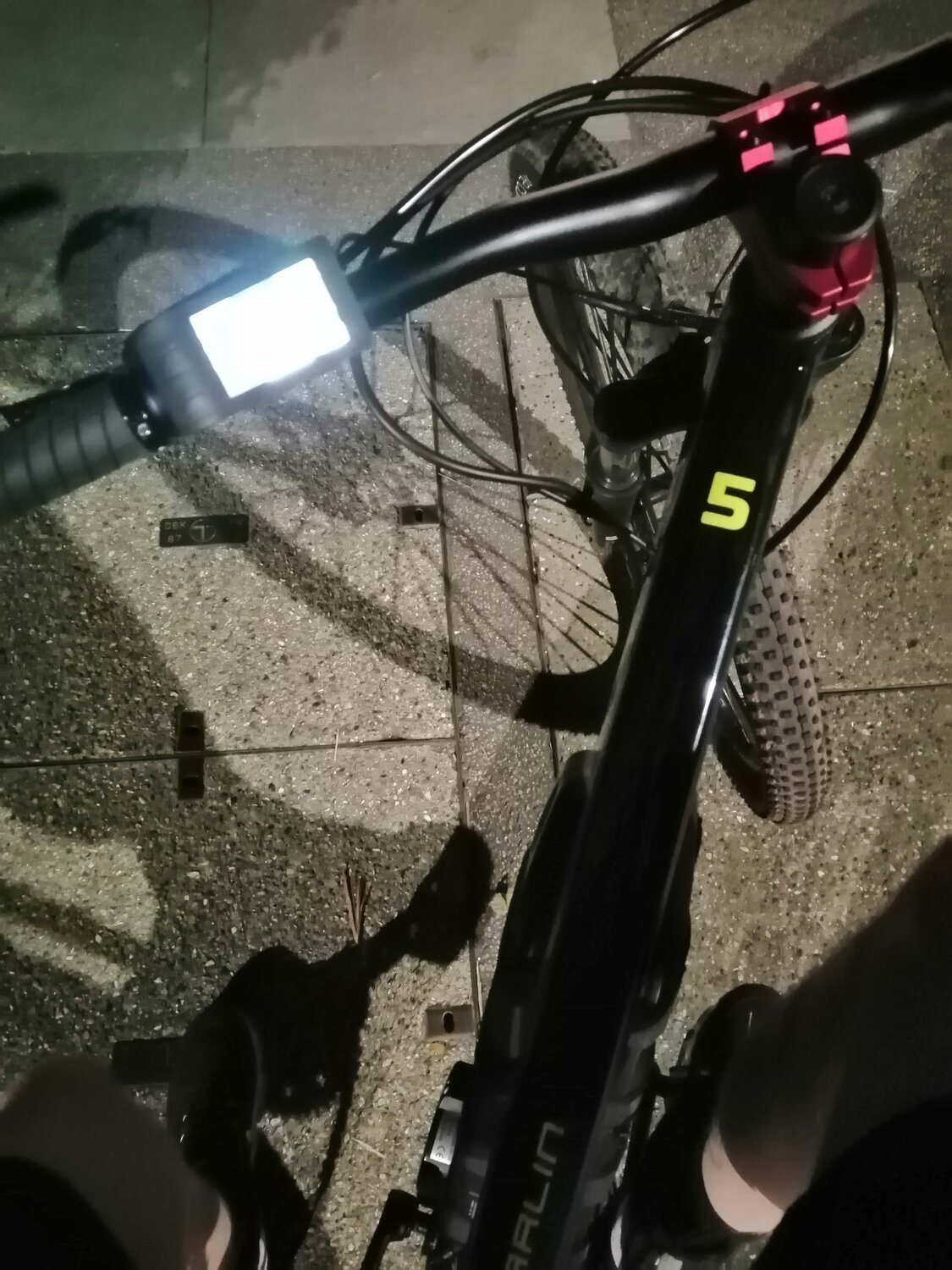

She's alive! Thanks again @Gionnirocket!

One of the cables got pulled out of the splice 😂
