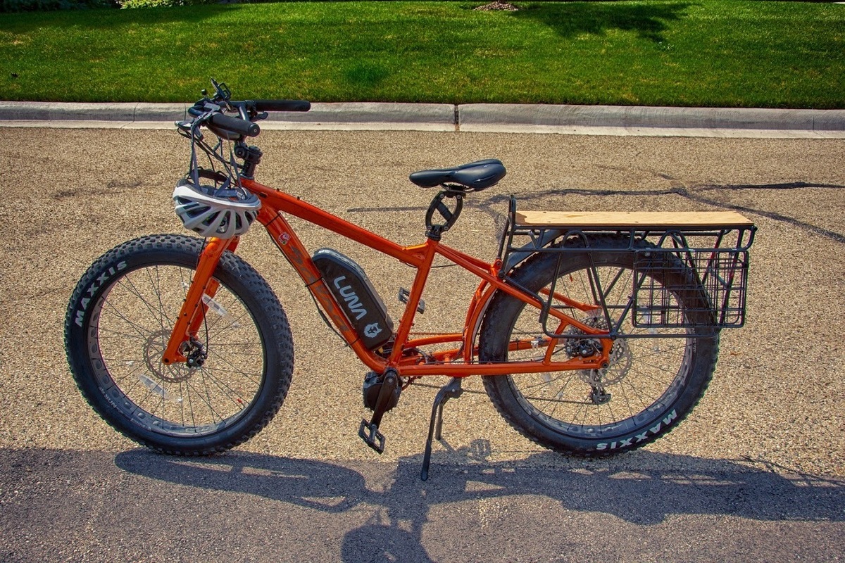

You can see the problem with this BBSHD'd Framed Alaskan. It will be worse on a Blackborow. But the Alaskan in this link illustrates well. Look for the shot of it hanging for a great angle. People still do Alaskans because the problem is not TOO bad. I almost did one myself from a frame kit a few years back.
Found one. Given the kickstand and folding baskets (!) I would say this owner is using it as a street cargo bike only, in which case the motor position is not a dealbreaker.

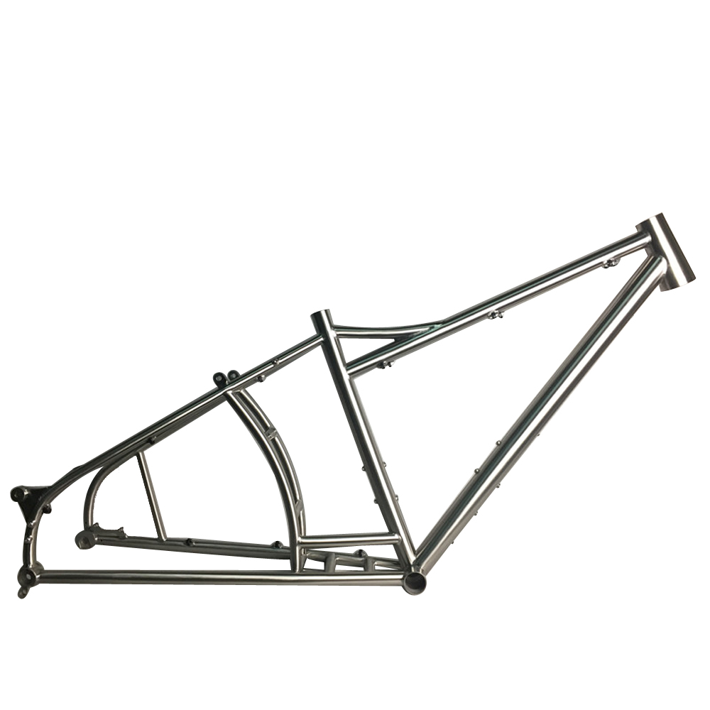

Go to AliBaba and search on 'titanium cargo bike frame' and you can see this clone and one other designed for an Ultra motor, I believe. I have seen a BBSHD build using this frame and with a similar clone rear rack.
That's an amazing frame. But the motor position definitely puts it in the 'paved' road only category. The extra bracing of the rear triangle puts me in mind of the Frey frames that are the only frames I have seen with some version of it. Perhaps if you could put 29 inch wheels on it .....
