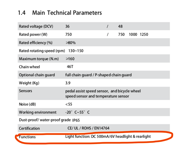

Your Google search should have found the answer. 6 volt 500 mA.
Seems very low... 3 watts for both head and tail lamps?
As harryS said... That's enough to drive a relay... not much more.

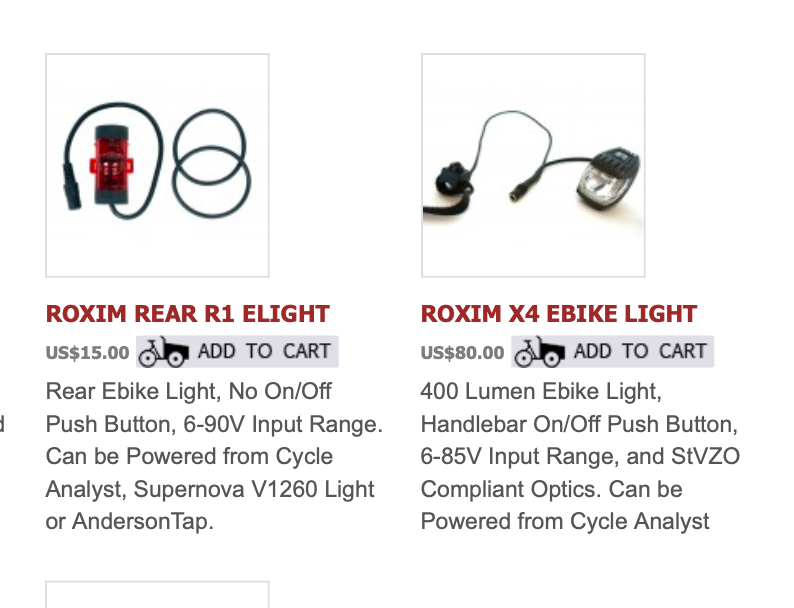

I never bother, I prefer German Cycling Light Standard StVZO. It's a proper light for road use, and lights the roadway, not a flashlight like beam into oncoming traffic.
My headlamps work off a Cycle Analyst or a tap into the battery cable. Roxim headlamp and tail light.
There are other StVZO headlamps available for less $$.
Thanks... Those are nice!

I did find a budget version on aliexpress. I searched using StVZO
I have the Roxim R1 (great visibilty) wired to turn on with my STVZO headlight (B & M IQX-E)

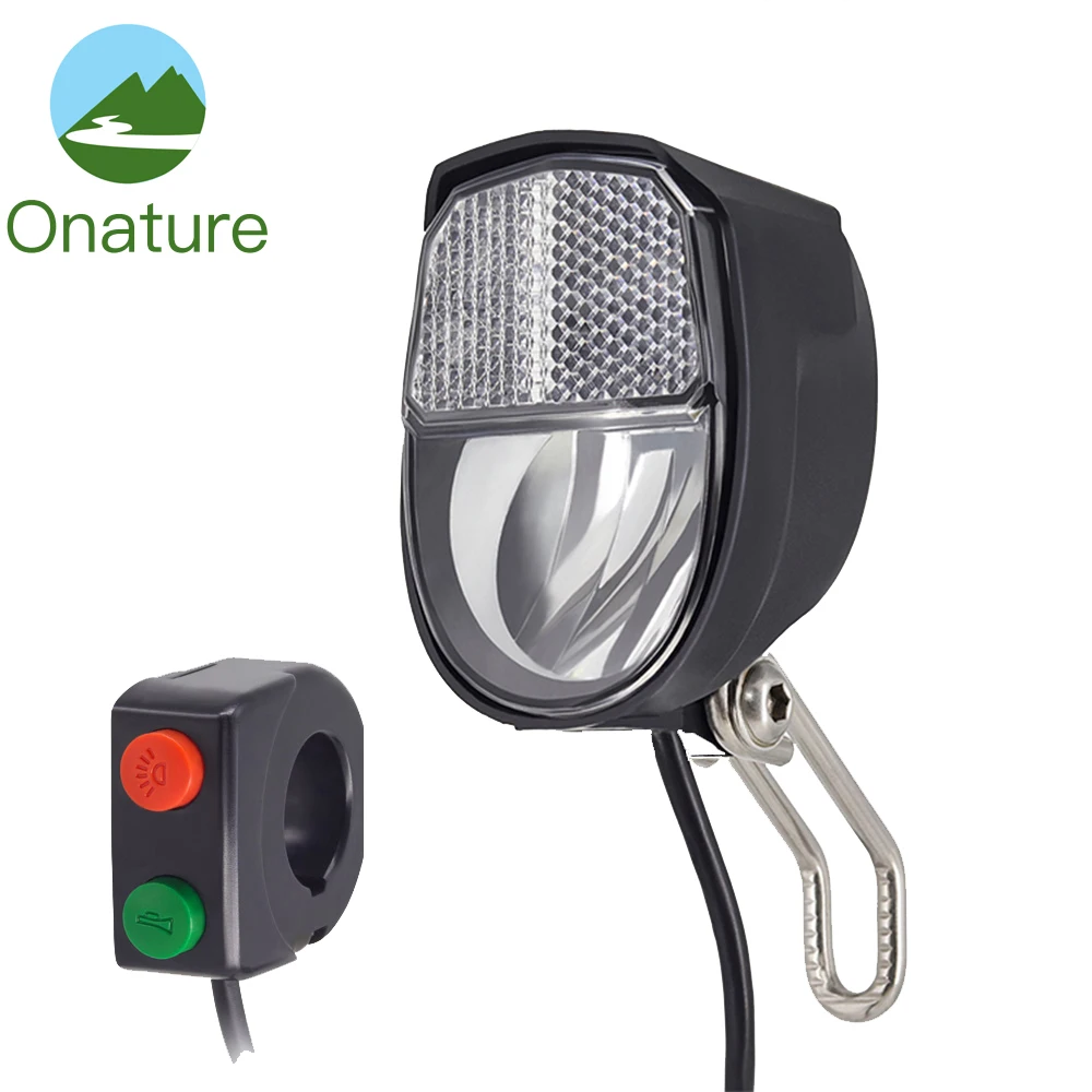

Ordered the light/horn and some relays. Thanks!
